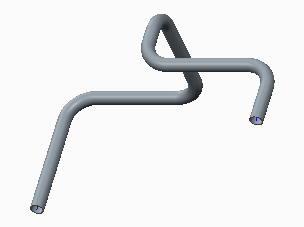

I use projected curves to construct wire path all the time, as in the example below:
saspinall1-VisitorAuthor
December 14, 2016
Thanks BH, would be interested to find out how you do these, look very nice indeed.
Stu
BHOoi
December 15, 2016
Thanks. Nothing secretive/confidential and I normally love sharing/exchanging  modeling skill. Attached is the raw file in creo 2 for your reference. Hope this helps.

December 14, 2016
Hi Stu
as already noted points, curves and sweeps will harvest the best control and you will be able to measure the length.
...but...
have you looked at the good old "pipe" feature?
I sometimes use it to get a rough idea where the best route may be.
it is buried in the list under "commands not in the ribbon" drop down
as with all thing ptc you may scratch your head for a minute or two
....but...with practice you can create a hunk of pipe/wire quick.
and drag the points looking for the sweet spot.
I always need the length so it gets suppressed and replaced it with a curve and a sweep.
see the attached creo2 model
