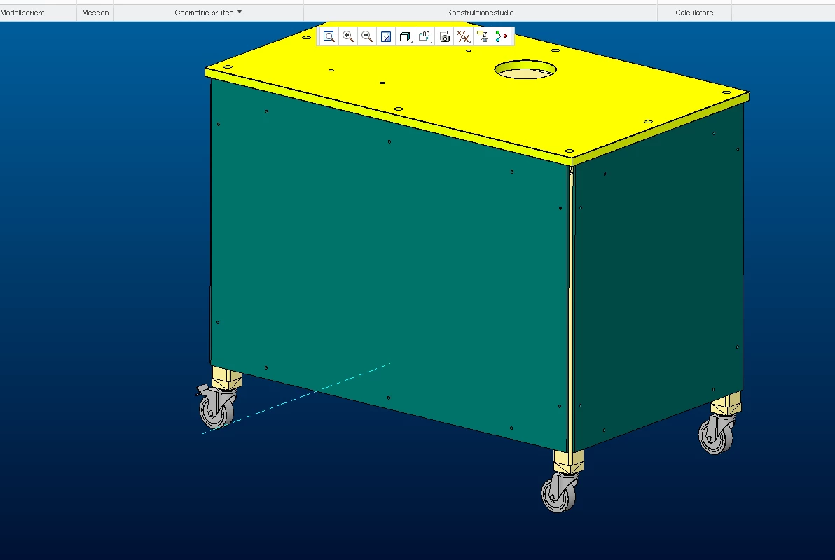

Hallo,
why are axis highlighted in model/assemblies by the mouse over feature and datums not?
Thanks, Claus
November 3, 2014
I see no datum planes in the assembly and if they are not shown, they don't highlight with mouse over.
For the axis, it should be the same, but of course I cannot judge by the picture, whether the axis is shown or not.
Note that behavior of datum features may change, when you use "Set Datum" on them (usually they show on screen, even if datum display is off)
