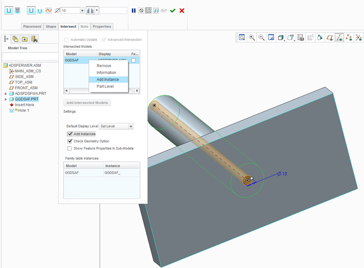

You can add assembly features to part as per below process. Basically it creates instance so parent/child relationship is maintain. This may be useful to you.
Hole created in assembly and visible in part level instance. You need to select display level to part level. By default it is set to top level.

Hi Jitu
Thanks for the feedback, Came to know the instance Option which is new for me.
It is read only, not able to change the parameters while inside the part mode.
Thank you
