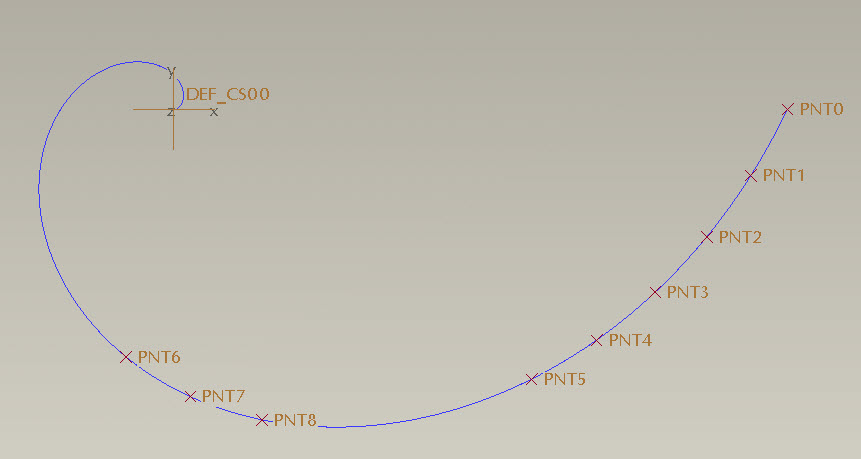

I thought I would spend a couple of minutes looking at this. It seemed a nice way to spend a little bit of Friday morning.
Most of Friday morning has now gone!
I made a datum curve of the right shape and placed a datum point on the curve. I then made a tooth-shaped protrusion on the curve, referenced to the point, so that the tooth attitude would follow the shape of the curve, instead of staying horizontal or vertical.
Then I patterned the datum point and reference-patterned the protrusion.
Strange behaviour then ensued!
I am at a loss to explain why the pattern of points, equispaced at 0.06 of the curve length pitch, should leap across to some apparently random point on the other side of the curve and proceed in the opposite direction after the first 5 points.
The number 5 seems to be magic - it always either reverses as shown or fails regeneration after 5 points.
Is this what you meant by the 'bounding-box', Antonius? I confess, I didn't understand what you meant before trying it out. I still don't, for that matter...
Any ideas?

March 15, 2013
By Bonding Box I mean that patterns create a 3D box around the patterned feature to determine the "origin" of the feature. This is rarely a usable location and creates real problems when following curves or sketches.
The problem you are seeing is not uncommon. I have no explanation for it and I see it all too often. It really should be reported to CS and driven to an SPR. I don't know if this is a Creo thing or if this has always been a problem but since you see it in WF2, it must be inherent to the code. In the recent Wave Washer models, I had this happened when following a surface too.

March 19, 2013
You have a student edition which full versions cannot open.
I have created the curve and used it to project into a sketch.
I placed a point on the original curve at the sketch's start point. So far, it is properly distributing the points.
I am using Kevin's equation from HERE
