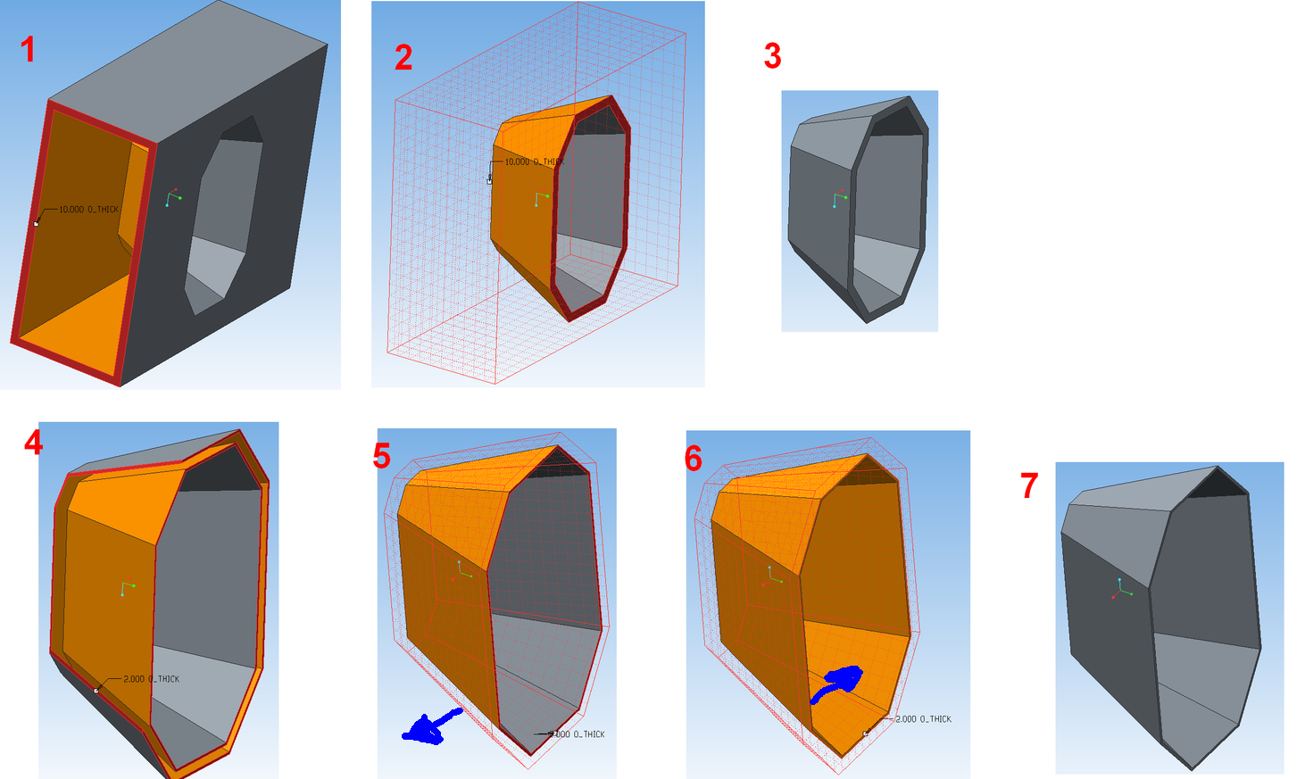

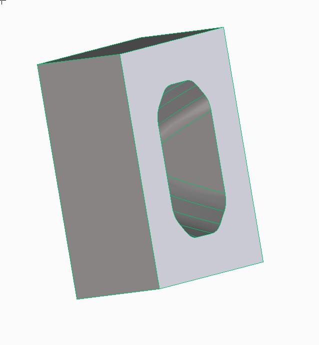

I want to basically make a 2mm thick "cap" for a head
I create a cube, then move the head part way into the cube.
then I Subtract the head from the cube -- leaving the cube that's inside fits perfectly onto the head.
Now I want the cube, with the inside the shape of the head, to be 2mm thick from the inside (shape of head) out. Thoughts?
PS. I know how to Shell the inside of a part to be 2mm thick. I want to "shell" the outside of the part to be 2mm thick

I want a 2mm shell thickness, from the inside out. I want to keep the shape from the inside, with a 2mm wall.

November 14, 2012
1..3 Create a shell as usual (10mm)
4..5 Create a new shell (2mm)
6. Change shell direction (outside)
7. Result
