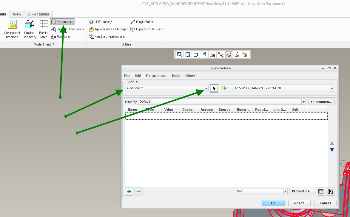

July 21, 2015
Isn't that a component parameter in assemblies?
July 21, 2015
I thought about that too, but I think the component value for sub-assembly components would be stored at the sub-assembly level, not at the top assembly level.

I tried the component parameter and it does require storing the parameter in the sub-assembly. So it would work great at the assembly level just can't go into the sub-assemblies.

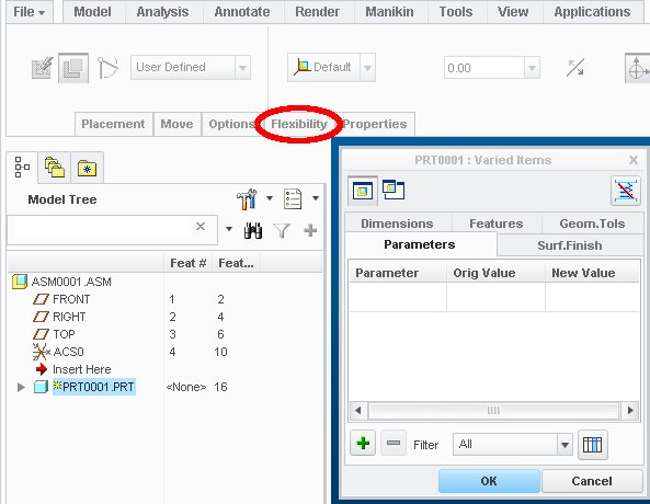

If I understood the problem correctly that you may want to take a look at flexible components. This way you can have a parameter value in the assembly context and a different value when the part is opened by itself.
The parameter need to exist in the part but it's value is independent from the assembly.
July 21, 2015
Keep in mind that as the number of flexible components goes up, Creo performance goes down.  A hidden family table gets created for each item that has flexibility defined.
