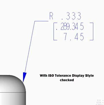

We're running Creo 2.0 Parametric build M030. When one of our users was creating a parametric note for a radial dimension, attaching it to another view, the orientation of the radius callout "R" moved in the dimension - instead of being at the beginning it moved into the center.

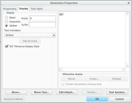

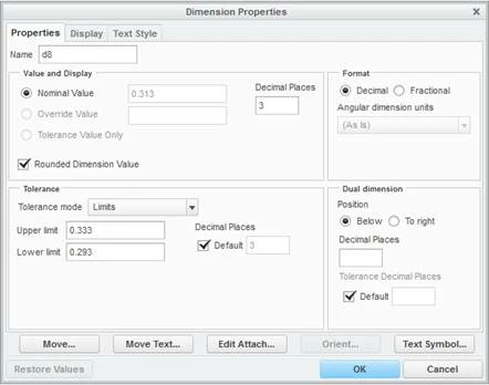

We use dual dimensioning and limit tolerancing. I've tried a number of things and found this - in the drawing properties, if I change settings as follows we get these results:
1) Here's where we started
[cid:image016.jpg@01CE71B2.EA0C6000][cid:image017.jpg@01CE71B2.EA0C6000]

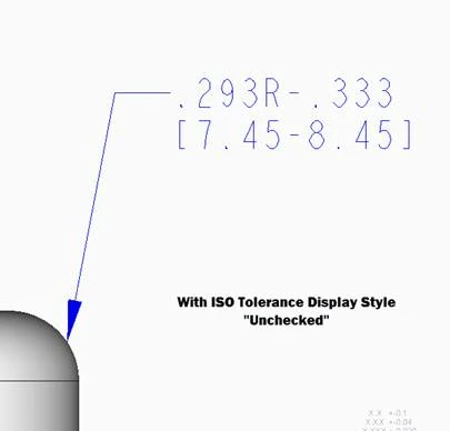

And we get these results
[cid:image018.jpg@01CE71B2.EA0C6000][cid:image019.jpg@01CE71B2.EA0C6000]

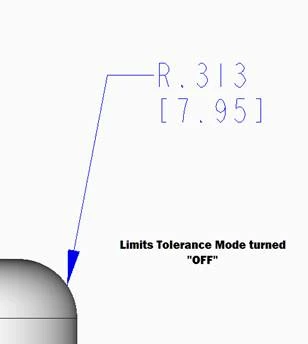

And finally, if we turn off "LIMITS" Tolerance Mode we get the radial "R" callout back where it belongs
[cid:image020.jpg@01CE71B2.EA0C6000]
The same thing happens with diameter dimensions. Has anyone run into this? Config settings, ........ ????????? Bug???????
