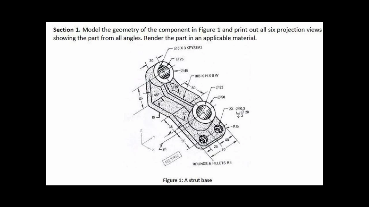

a small tutorial made it once 4 a student.... it shows how to make a prt with help of DTM mirror hole etc.... hv fun
