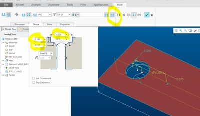

Recently changed a part modeled with a countersink to a countersink with a counter bore. It is a simple part with this feature patterned once. By doing this, though, the pattern is lost. Why would this happen if all of the changes are make within the "Hole" feature for the first hole?

Here is how it was done.
I clicked on the counterbore icon.
I updated the circled values in the chart.
I accepted the change.
The pattern failed.

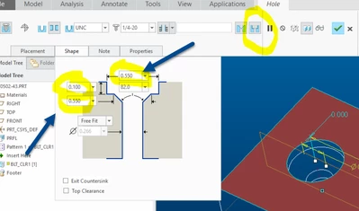

October 27, 2020
I'm wondering if you forgot to change one of these values. I'm guessing they are the same number. If they are, the pattern will fail. The ID of the Cbore needs to be smaller than the OD.

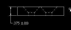

This sounds like a great thing if I was making a complex part. This is simply a anti-marring pad on a fixture and I just want the heads of the flat head much below the surface. I just came across this when modifying the hole from large Csinks to the Cbore/Csinks by the advice of a machinist. Then the pattern failed (on about 6 different parts) and the parts on at least as many risers.
