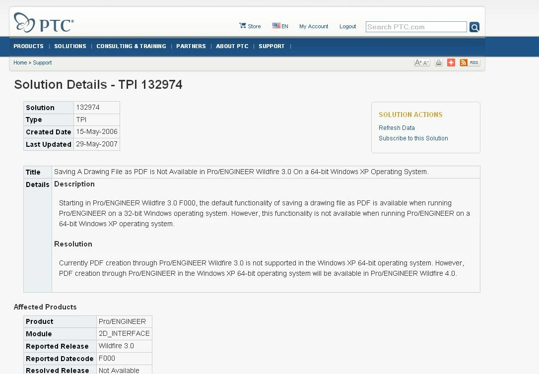

All:
We have a user here with a new Dell 64 bit that y'all recommended for
him. The question is: how can I get him to make PDF's with a 64 bit
Dell running Windows XP and Wildfire 3 M100? I gave him my mapkey, but
that still didn't work. Let me know if you need any more information.
Thanks is advance.

Tom,
We wrestled with this issue for quite a long time before we found out what the issue was. We have (2) XP-64bit machines and (1) 32-bit machine. The x32 was always able to save as .pdf while the x64 could not (we were using WF3 at the time. It turns out that at the time PTC made WF3, Adobe needed some refinement to operate in 64-bit environment. So save as .pdf was only available in the x32 version of WF3. As far as I know, there is no work-around either other than to use a x32 OS and WF3.
Sorry I only have bad news for you there.

I had that same problem when I was running WF3 64-bit on my XP x64 machine. You can actually install the 32-bit version of WF3 on the x64 XP operating system. For awhile I had both versions installed at the same time, though there was probably a better way to deal with it 🙂
FYI - WF4 and WF5 64-bit have "restored" the capability to export pdf's.
