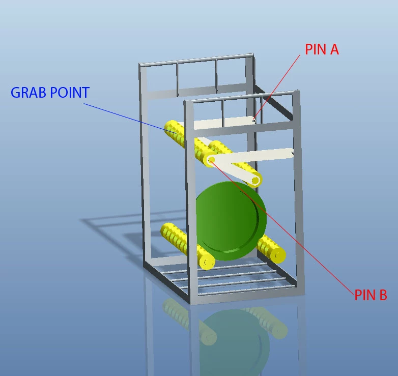

From the attached picture you can see my assembly. I am "drag"ing from the yellow roller.
when I drag the first yellow roller, from the drag point upwards, I want the second yellow roller to fall (via gravity) but stop when it hits the green disc.
Is this possible without entering animation or mechanism?
Lee

From what I see I would say no. The only way I see this being managed is by using mechanism connections & constraints.

There probably is a way to do what you want, especially if the lower yellow roller is always in contact with the green disc. You can create an arc surface in the upper arm to constrain the lower roller using a point-on-surface constraint and do something similar with the disc. Don't have time at the moment to get into more detail, but I think you can do it.

It is not possible without Mechanism Dynamics (MDO license). While using MDO, you can define the direction of Gravity, whether along X, Y or Z direction. Any other definition would be YOUR perception of how the articles are going to behave which may not be correct.

Thanks for the tips guys. Figured it out in the end.
Created my pin connections, entered mechanism then specified a cam involving the back roller and the disc. Worked a treat!
