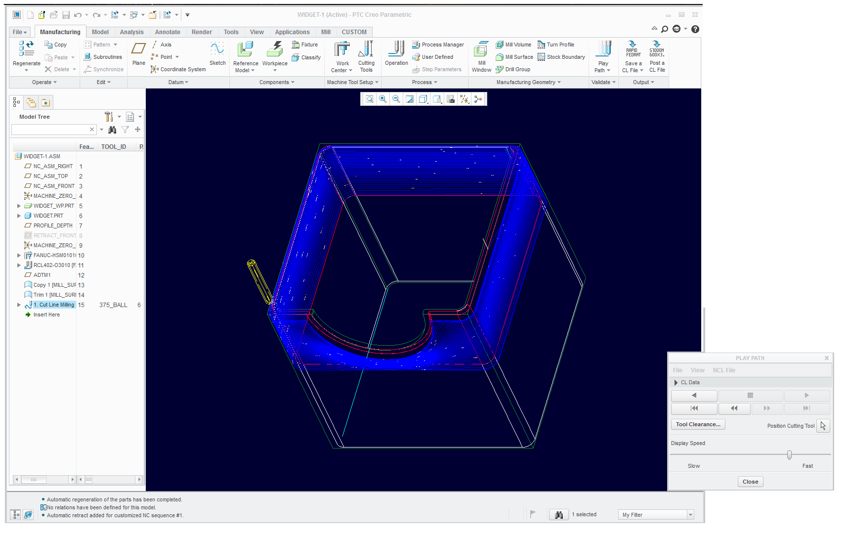

using cutline milling with a helical scan type

I agree, Steve's suggestion is exactly what I need, planar profile cuts, rapid across gap without retract. Mike's toolpath machines the entire profile so it's not quite what I need.
I tried volume milling but had major difficulty creating the mill volume. Once that was done, tried many combinations of parameters but saw no useable toolpath.
Dumb question: Is there a way to create mill surfaces with styles? I created a sweep mill surface, no problemo. I then used COS by intersect to create curves on the surface with a plane, then trimmed the surface so that it can be milled with planar cuts.
But the resulting style is not a mill surface, at least according to the model tree. Profile milling ignores it. So, I created mill surface with boundary blend from the style. The profile module likes it and does its thing.
