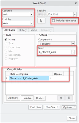

Example of a retrieved search query:

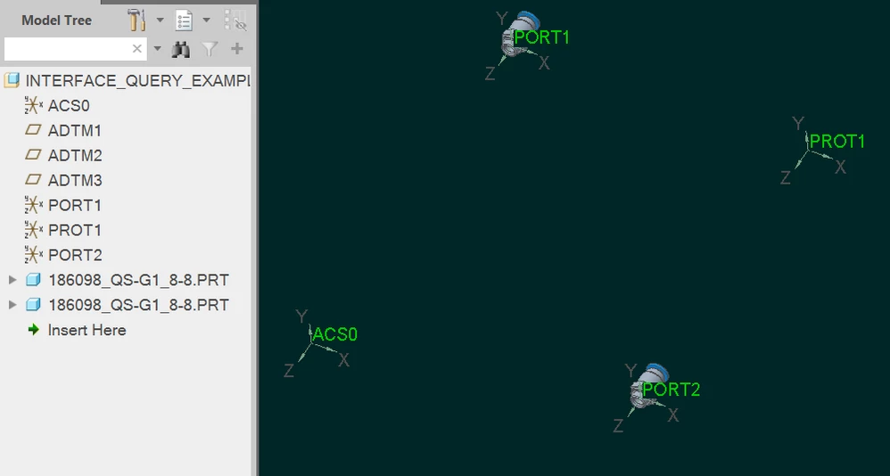

This method worked for me:

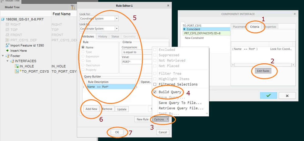

1) define the interface in your component and attach a query to it:
2) upon assembling of this component, set it for multiple placement:
pausob_4-1650107505227.png ->
Select the interface and click "Multiple" button.
3) Click on the Auto Place button:
4) In the Auto Place dialog box, define the search scope (screen point method did not work for me, but selecting the top level assembly as the item did), then "Find Now", then click in the locations found list, Ctrl+A to select all, click ">>" button to transfer to the selected list:
5) Close the Auto Place dialog box, click the green check-mark and it is done:
System auto-placed the fitting according to the criteria that the mating coordinate system is named PORT*System auto-placed the fitting according to the criteria that the mating coordinate system is named PORT*

After further testing we have run into a problem where it is trying to assemble to coordinate systems within other sub-components.  As far as we can tell, the multiple locations autoplace doesn't distinguish between datums within sub-components and top-level datums, nor could we figure out how to specify this in the placing component Interface feature.
How do we specify to only use the named coordinates in the top-level assembly?
