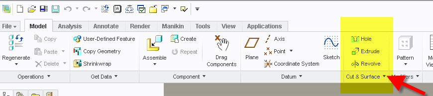

With an assembly open, it uder the Model tab CUT & SURFACE.
Hole, Extrude, Revolve are shown, hit the little arrow shown and it gives you other options, like sweep, blend, helical

I looked in Cut & Surface, but I don't see Assembly Cut? Is it called something else??
March 2, 2016
Since you are in an assembly, they are all "assembly cuts" (other than surface creation). Extrude for a cut normal to the sketch, revolve for a cut around an axis, sweep for a cut along a trajectory, etc.
