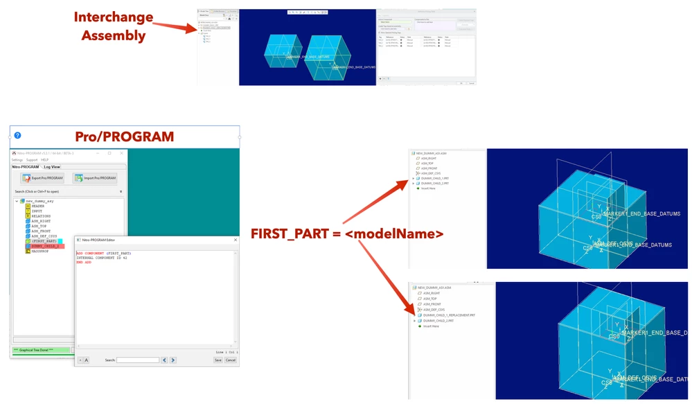

The attached is an example using an Interchange Assembly to facilitate the interfaces.  If I had a high number of items that I wanted to dynamically place, I would consider a skeleton and CSYS instead - to keep things more robust and less dependent on specific planes being defined in every model.

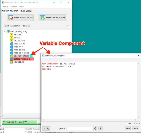

You are right to look at Pro/PROGRAM to replace the component using a variable - that is a very good way to plan for new components as options.  Here is the View in Nitro-PROGRAM of the variable definition for the first component placement:
The Variable reference in the Pro/PROGRAM does give you a lot of flexibility for dynamic placement of components, but assumes some common references be defined for them to properly be placed and regenerated.  Kudos for this approach!
Attached is an updated version of your model using an Interchange assembly to reliably constrain the assembled component - based on your variable placement using Pro/PROGRAM.  I removed the Layout/Notebook declarations.
Hope this helps.
