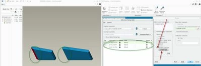

Using the replace command, select the "unrelated component" option (also good to uncheck "remember these components" unless you want a permanent reference to remain on how to replace the parts in the future).
Select your new component.
Use the "edit reference table" button. Creo makes an assembly of the 2 parts, and generates a list of the references used by the existing part.
Choose the coresponding reference for each on the new part.

Just to add onto using the replace by unrelated component, I would do the replace command in your upper level assembly and not the lower level.
