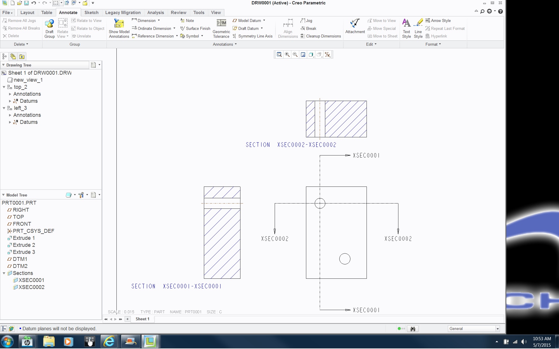

I just went through a problem one of my users encountered again. It's something that pops up on occasion but never with any sort of regularity, consistency or repeatability.
He created a section in his model that cuts through the center of a hole (or a hole-shaped extrude). In the model the section displays 100% correctly. However, when placing a drawing view, the section does not behave correctly. No matter what actions taken to try to resolve this the x-hatching does not display properly and it appears the section is cutting through a different location.
The only fix appears to be moving the x-section datum plane so it's .005" off the axis of the hole it goes through. Once that is done, everything looks the way it should.

The problem is an evaluation problem. It doesn't have as much to do with the axis as it does that cylinders have two surfaces with joints between them and the cross-section software is having trouble in figuring this out. Since the joints share common vertices the intersection calculation can't determine for certain which of the two surfaces have priority. When you offset the section by .005 you are moving the evaluation away from that joint.
The problem has been around since rev 13.
AFAIK there is no general fix; moving the section plane is the most frequent choice, but maybe accuracy changes would also work, though it causes the entire model to be re-evaluated.
If you turn the Sketcher section (not cross section) orientation a few degrees, 90 seems like a good value, the joint in the cylinder will be rotated and the section plane won't intersect it, but that's a lot of trouble; the offset is easier.

It's not the shown axes. Showing or not showing them doesn't affect the error in any way. It's the axis created by the hole feature or a circular extrude feature that I was referring to.
Without testing to verify, David's reasoning makes the most sense with the vertices all lining up. Just a shame that PTC hasn't figured out how to fix it in all this time.

Arrgghhh, I hate when this problem happens. We get it here generally on large assembly models. Something about that x-section that the drawing can't handle. We also do the minor offset to correct the issue usually. It always comes with a line in the message log Cross-section creation in view "right_16", on sheet 2, aborted.

It doesn't abort the creation. It just doesn't show correctly. It allows the section to be created and applied to a view, it's just messed up.

There is no adding of an axis. There is no showing of an axis. The plane isn't for the axis, it's for creating a section in the model (View Manager). Pick a datum plane in the model tree, then pick View Manager > Sections > New etc. and you'll have a cross section in the model that uses that datum plane as the location of the section.
That section is then shown on the drawing. But, it doesn't show correctly once in a blue moon because the section happens to rest on the axis. Or, according to David's explanation, the axis and the edges of the hole shells are all lined up and Creo simply freaks out on occasion. And it happens even when the axis isn't referenced at all.

Something to try: File > Prepare > Drawing Properties > Detail Options, enter 'update_drawing' for the option name and 'all' for the value. Regenerate your drawing. That tells the drawing to update to all version-protected bug fixes. If that fixes it, then you can either do it that way (and inspect the drawing to be sure nothing changed that you'd rather didn't), or if you have an SPR filed for it, we can hunt down the precise versioned fix.
