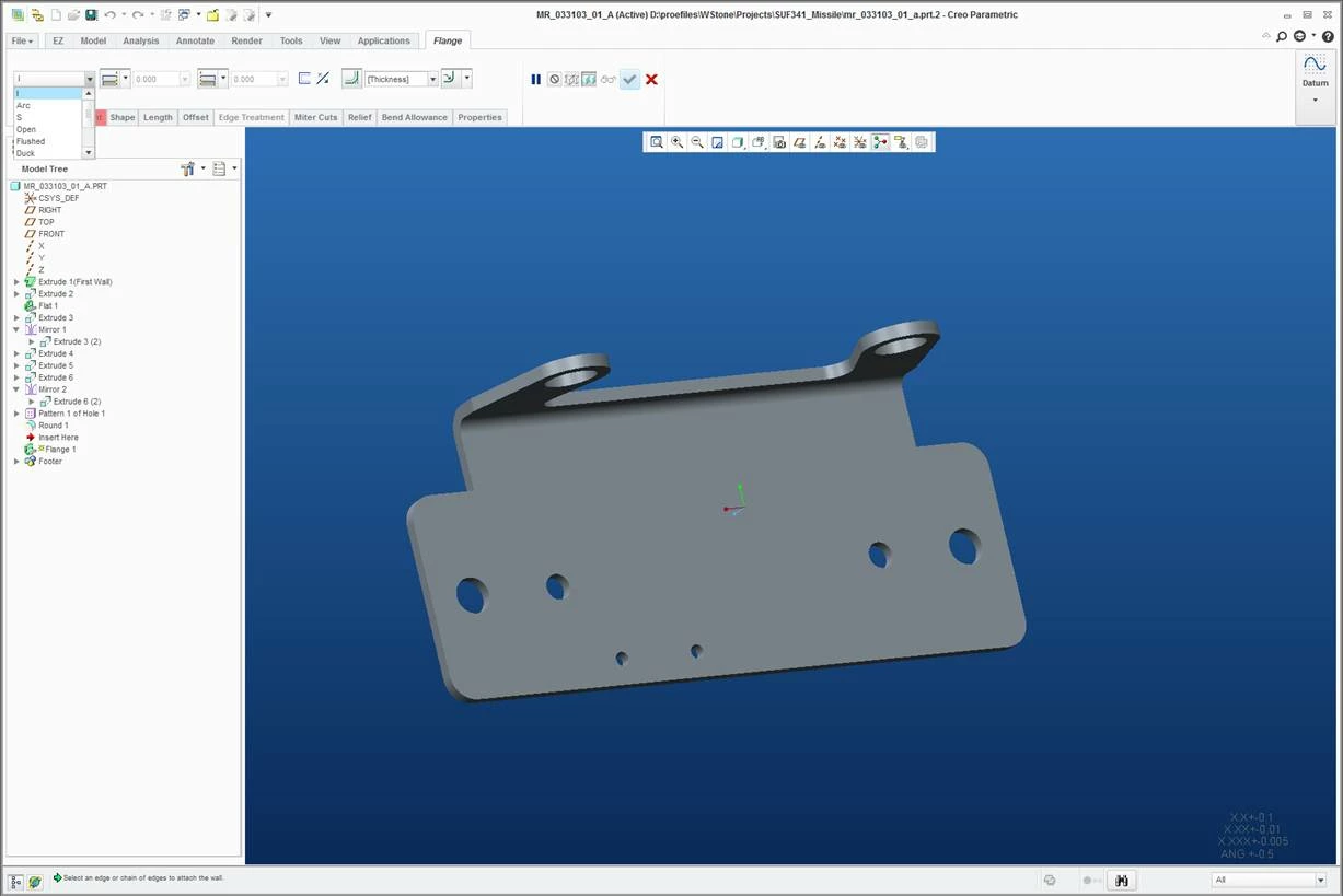

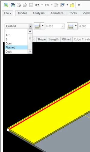

October 8, 2013
Flange
[cid:image009.png@01CEC444.4222CC00]
Then select the edge to attach and select the shape
[cid:image010.png@01CEC444.4222CC00]
[cid:image001.jpg@01CEC444.4301BA50]

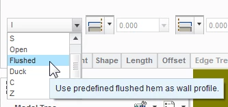

October 8, 2013
David
This is an option under the Flange Wall Tool
[cid:image002.png@01CEC44F.53F46870]
[cid:image007.jpg@01CEC44F.53F46870]

October 8, 2013
David,
The tools listed below can be found under the "FLANGE" button on the Shapes section of the ribbon. Once selected, down arrow on the "I" selection box
[cid:image001.jpg@01CEC447.63A3E2D0]
