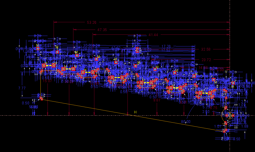

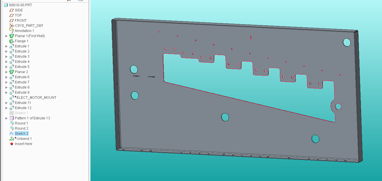

I know that this is an old thread, but I am coming up on the same issue. I have a fairly involved side sheet that I have cutouts to mount the parts to. I have created the geometry in multiple sketches and extrudes to keep the sketches more simple. But now I want to use this geometry (what's highlighted in red) on a new side sheet for a slightly different application. I tried making a sketch and projecting the edges, then copying the sketch elements to a sketch to use in my pallet tool. When I do that, creo dimensions every point, and not so intelligently (see pics below), and the sketch lines don't line up at the end points, so it's an open sketch. If I start trying to constrain stuff intelligently, the lines end up moving. I'm better off just redrawing the features from scratch and using the original model as something I can measure off of or refer to the individual sketches. Blocks would be awesome in this case. What I'll probably end up doing is copying this part out and seeing if I can modify the base structure to what I need. How would you guys handle this situation?
Part I want to get info from.
what the copied sketch looks like, (after I tried to sort out some of the stuff)

What I would do is assemble the 2 parts together in an assembly positioned such that the cut is where I want it and then project the edges. Then, one at a time, I would remove the references to the other part and dimension as I needed it to be dimensioned. I would also break up the large feature in to smaller functional features.
The sketch you are making will work, but you have to remove all the references to anything except centerlines or construction lines contained in your sketch. References to your part will be lost when you pull it in to another part.
You can also copy-paste features. I've had some success with that too.
