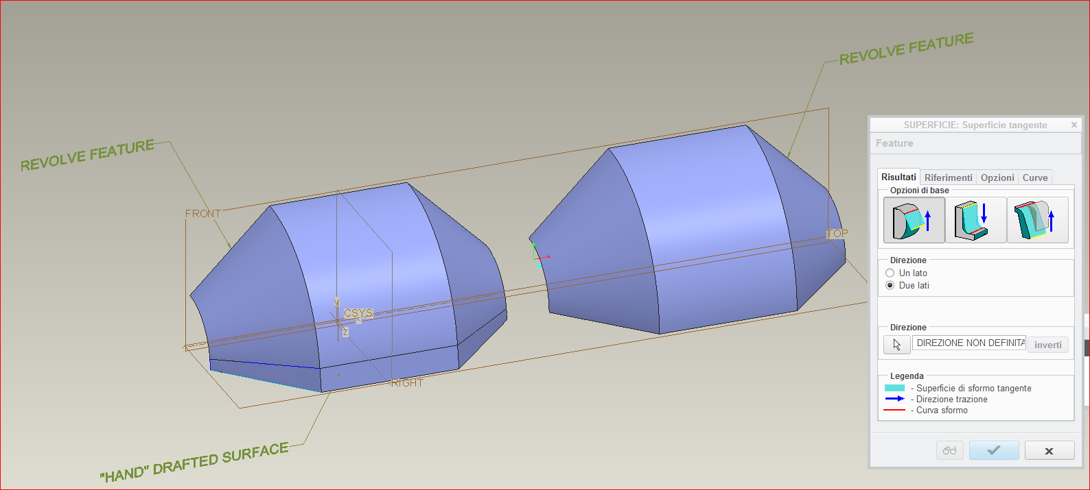

Hello to everyone,
i was asking if you have an idea how to get a draft surface which starts tangent to a revolve surface and goes down with a constant draft angle.
See my file to better understand what i'm asking for.
Thanks to all.
May 31, 2016
I don't thin you can with a draft feature.  I'd create a plane at the appropriate draft angle to the TOP plane and create an extruded feature using it as the sketch plane.
May 31, 2016
I agree with Doug,
Create a plane, trim and then use a extrude feature, you can also extend the surfaces normal to a plane or use the "variable pull direction draft".
Another option is the sweep feature, but you need to add radius to get tangency between the curves, this would be my choice.
If you're exploring the "blend tangent" feature take a look on bellow posts:
Blend Tangent to Surface
About making draft lines
Jose

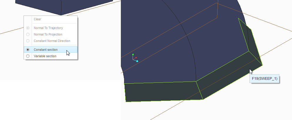

June 3, 2016
You don`t need the rounds if you use "Constant Section" option for Sweep.specialdraft.png
