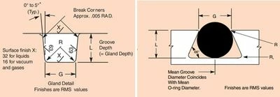

O-ring Groove
The standard o-ring groove dimensions often to to a virtual sharp condition.   Regular o-rings have virtual sharps at the bottom and dovetail have virtual sharps at the top.    Do you use virtual geometry, or special notes, or convert the tolerances to a more GDT based notation?
Example groove drawings (Source)

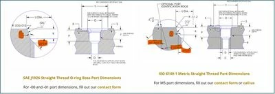

Hydraulic Ports
In some of the hydraulic port standards, the dimensions have angles to virtual surfaces.  Do you just redraw to a coinvent real surface, or add virtual surfaces.   (When a standard port is used, we could just specify the Standard Spec)
Example J1926 and ISO 6149-1 port images (Source)

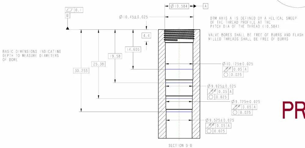

I have seen drawings that document measures to a theoretical sharp corner, typically these dimensions are noted to aid in design/programming of the desired geometry and not inspection (QA) dimensions. In your examples it appears that these virtual elements are added for the same reason (to facilitate the creation of the desired geometry). I would not expect to see tolerances associated with such elements; they would be treated as a basic dimension for GD&T purposes. In your examples the virtual elements are not critical to function of the physical parts, and I would not expect to ever ask that they be inspected during production. They may be used to verify/validate tooling but not to approve the parts themselves.
Here is a section from a similar application (3-way valve sealed with o-rings) where the dimensions and DRF are used to define how the parts are to be inspected to meet spec for reliable sealing. Note the use of basic dims to locate virtual planes in the bore where the seal is established with the valve in situ.
