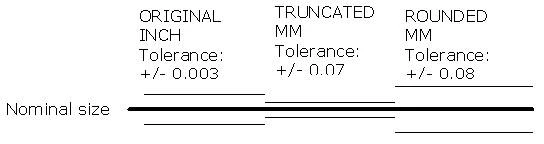

Tolerance - decimal places not rounding up accurately
Have an issue with Wildfire not rounding up accurately
The properties of the dimension are as follows.
Duel Dimensions primary = Metric & secondary = Inch
Dimension Properties menu
tolerance mode = +- Symmetric
tolerance = .38
Format = Decimal
Number of decimal places = 2
When I use these settings the tolerance on the inch dimension displays as
.014
It should display as .015 because it is actually .0149606
