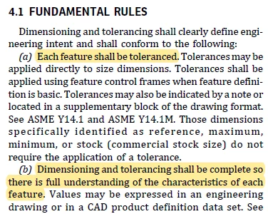

If the dimension is not critical to function, should it be on the drawing or inspected?  I would argue that the .02 radius should not be on the print, perhaps you could specify it as a max radius permitted.

As far as leaving non-critical features undimensioned, that would violate ASME Y14.5.  Every feature must must have a tolerance:

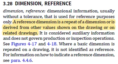

I toyed with the idea of using reference dimensions, but that doesn't fit with the Y14.5 definition either since that radius (for example) can't be derived from anything else:

I have see some drawings where they have the blanket statement "Reference CAD data for dimensions not shown". Could you incorporate a tolerance into a note like this?
I have also see a critical dimension symbol on those "critical" dimension. Maybe add these to ones that cannot be overstepped.
