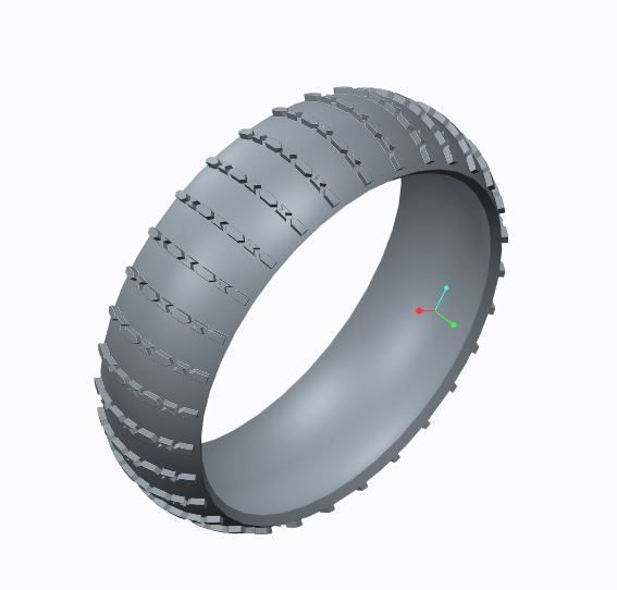

Hello i went through a guide with torodial bend : Tutorial: How to model Tire in PTC Creo Parametric and show design intent - GrabCAD
I did the basic part but what i wonder is how he does step 11 and build on (extend) the sides of the tire. I cant choose the side or anything what is best way to do? he says to the step 11 description that he used revolve cut etc, but should you instead before making the Bend have a wider part where the sides are not with pattern like this:
Picture 1-widetire
STEP 11 - HIS PART IS TO THE LEFT, MINE IS TO THE RIGHT

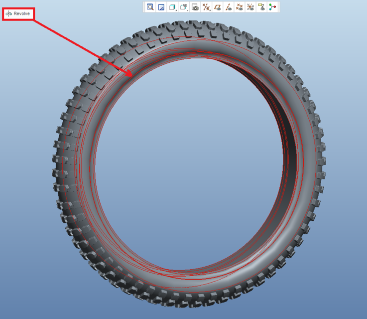

Hi Bjorn,
He's just saying you can add any other feature you wish at the end. It looks like he added another revolve to add in the extended sides. There are a few ways you can do similar things in Creo. You can also look at the Flatten-Quilt / Flatten-Quilt Deformation commands. This offers another potential method for achieving similar geometry.
Toroidal Bend is one of those rarely used niche functions in Creo. Some people make them to just to demonstrate their prowess but you rarely see anything created with them other than a tire. Literally, they may as well have just called it Tire Feature. However, flattening a quilt and then bending back solid geometry created from it can yield some pretty amazing results. I'd encourage you to give it a try!
-Brian

Hello brian and thanks for the answer. okey but how did he use the revolve to extend the side? and make the revolved geometry be coincident with the tire geometry (as you cant select the side of the tire where his revolve extends)
Ok thanks, I will look it up
