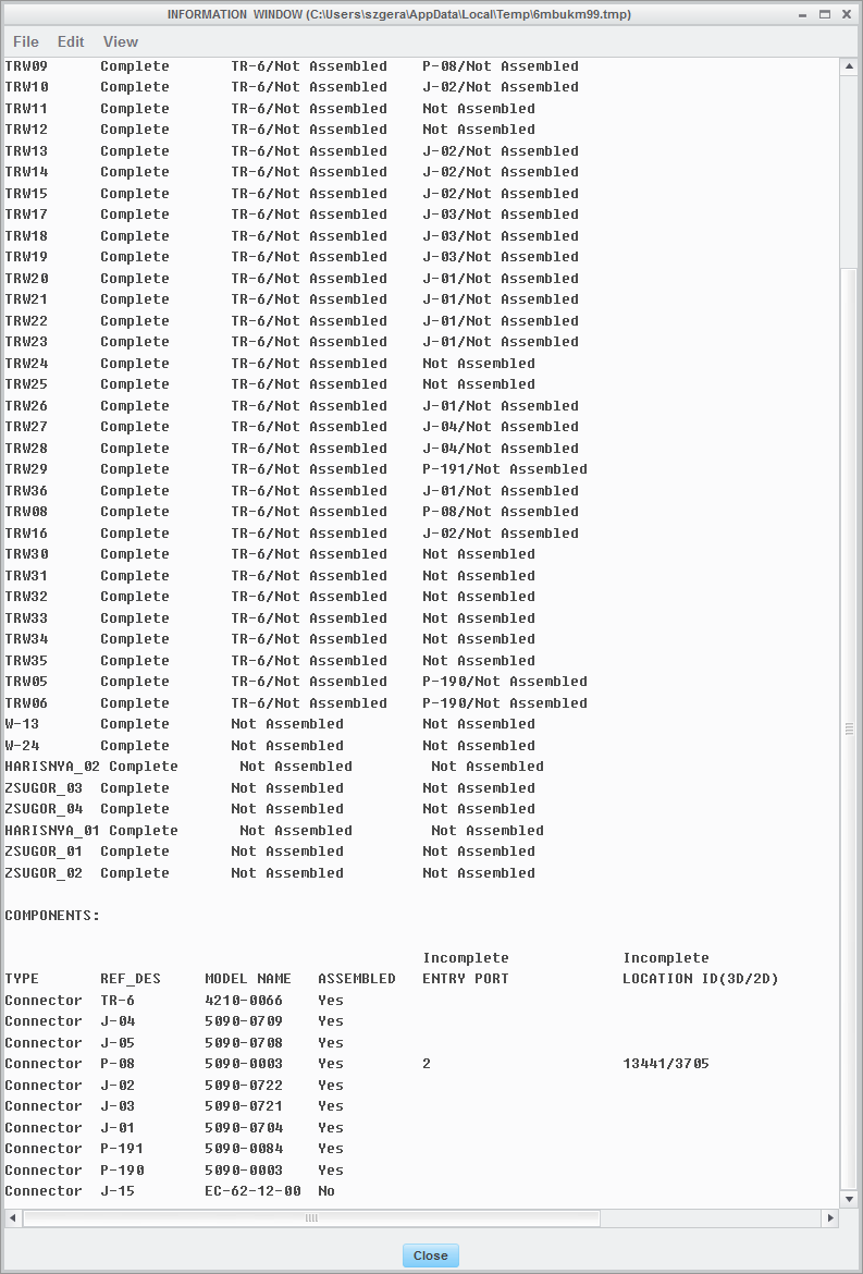

Currently we're struggling with a problem related to updating existing harness-->harness mfg (flatten)-->harness dwg, please help me solve this issue.
So I had to change a connector in one of our designs (in Creo Schematics wiring diagram), the connector's part number, model name and connection of the wires changed. Actually the 3D modell of the connector didn't changed, we simply copied the existing one, and renamed it to match the model name parameter. As far as you are in harness mode it works fine, we have replaced the "wrong" part in the harness with the newly created one  (copied one), we deleted the old one in the auto designate dialog, after this the new one was automatically designated, the position of it didn't change either; we routed the cables again, and in the compare dialog it shows everything is fine, connected. So we moved on to the flatten mfg part, but in the mfg part id doesn't want to show up. If we go in the Flatten-Components the Assemble and Assemble All buttons are grey eg. not functional, like you've already Assembled every part to the mfg. , but the new connector doesn't show up.
However if we list the Harness Information the connector is showed as not assembled (as you can see the picture below, last line connector J-15 EC-62-12-00 Assembled = NO witch is correct by the way...) but how could we assemble it? In the drawing mode the logical data doesn't appear off course, so after harness mode it's useless.  Do you have any Idea where do we wrecked it up? And why does it show the connector (this means that the data was transferred to the mfg, however it doesn't handle it or so...??) if you cant assemble it to the flatten? We simply couldn't solve this issue. Thanks!

Hi Laszlo,
If you copied the existing connector and replaced it in the harness, chances are your network entry ports are still referencing to the previous connector.  You will need to verify the network entry ports are assembled to the new connector.  Make sure you regenerate and save the model.  From there, once you open up the ".mfg" part, delete the old connector in the model tree.  Verify that your flat harness is completely flattened out.  Then assemble the components.  Give that a try...

Hi!
Thanks for the answer, we tried it that way, and nearly any ways but unfortunately is doesn't work, it does the same thing every time. We tried to delete the component from the model tree, from the work environment, we tried to add the new one with the assemble option in cabling, we regenerated all the wires and cables connected to this component (this would be a total disaster, the point of updating an existing harness would be, that nothing changes, just that one component what you want to update. We have a totally organized and finished flatten harness model, it took hours to manage it to look like this, and it would be the same with any other cable harness, it wont be good to regenerate everything from the beginning because of one connector... ). I may ask you a different way now. How would you replace a connector (from an existing harness) to another one without changing anything else in the mfg document?

Laszlo,
have you tried to delete just the wires immediately flattened to the changed connector then re-flatten that portion?
