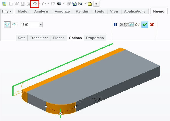

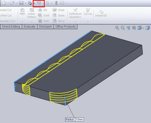

Here's one example I posted on MCAD Central a year ago. I have not checked if it's improved in the later versions of SW.
"Mindripper, there are many areas in SW where the Undo doesn't work and I believe I read on Mike Puckets blog that SW users weren't happy at all about the Undo command.
Here's one comparison between SW vs Creo. It's the same funcionality in WF5. I don't know how many versions this goes back in WF.
SW2010 where the Undo is greyed out and you can't undo or redo geometry selections.
Creo 1.0 where you can Undo or Redo geometry selections within a command."
