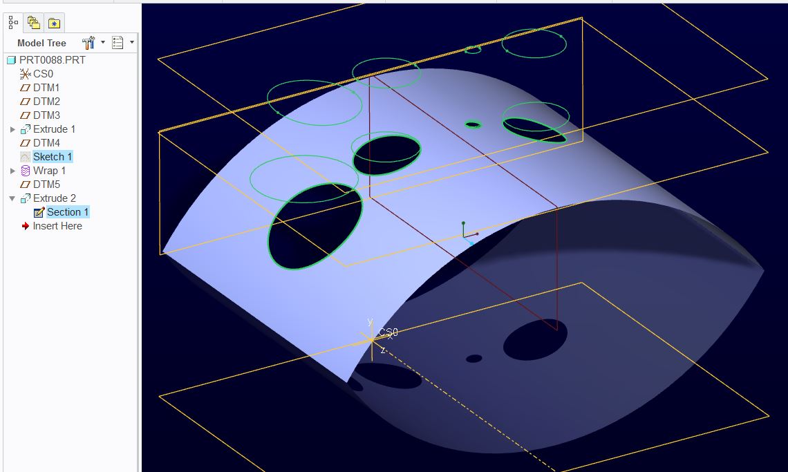

Hi modellers!
I have a sketch (imported from illustrator) that I've have wrapped onto a curved surface.
Now I want to use the wrapped sketch to trim the surface.
The problem is the fact that I'm only allowed to pick one outline for each trim. This means that I have to really many trims to get the surface I want.
Is there any way to do this proces more efficiently and speed up the proces?
I want all the centers of the circles cut out, like the three in the lower left corner.
Best regards.

In some cases, you can project those curves back to flat plane sketch and then extrude that sketch to remove material. In your case, this would work easily as the curved surface is less than 90 degrees.
Patriot_1776
April 9, 2013
Query-select the curve and see if it won't let you select the ENTIRE curve (composed of all of them). If not, as Nike says, Just do It.
April 9, 2013
PTC isn't listening to Nike... You can only select a single closed loop in the trim tool. You get the option to select the Rule-based "All curves in feature" but it won't allow selection of a wrapped sketch with multiple closed loops.
On the other hand, you can extrude a thin feature and remove material, which, of course, has to be planar. I see room for improvement here

Thank you for your answers both of you
I manage to solve the problem by projecting the wrap back to the sketch plane and extrude the holes away.
If you have a surface that bend more than 180 degrees, you have to do it the hard way?
Thanks again.

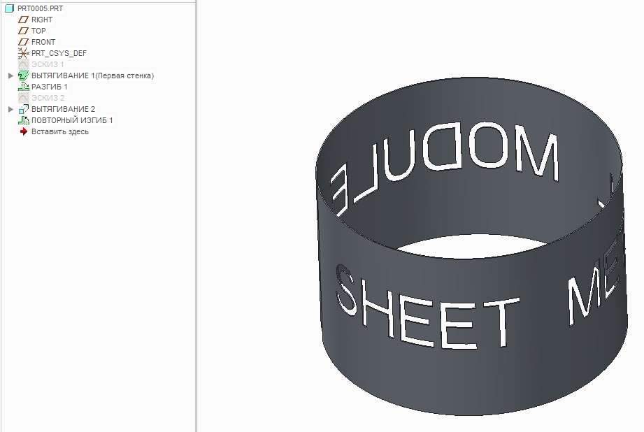

April 10, 2013

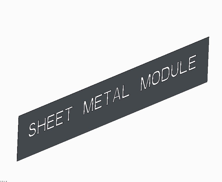

You can also use Sheet Metal Module for this purpose.

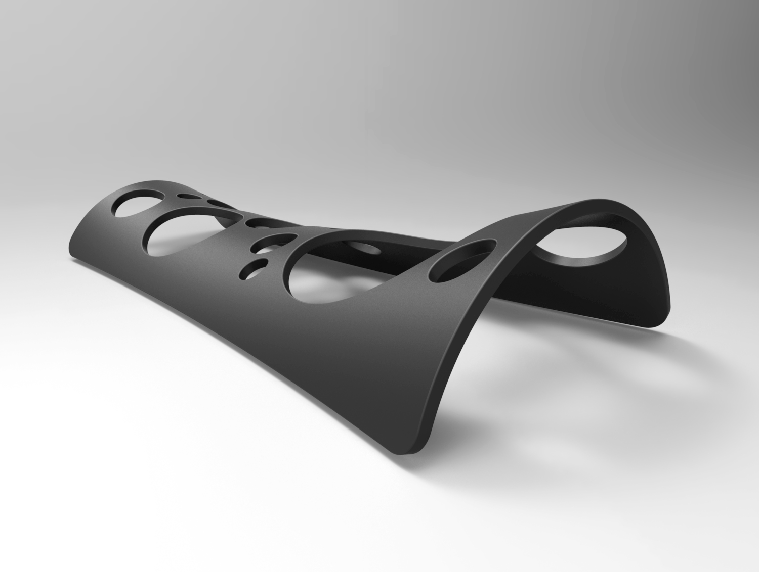

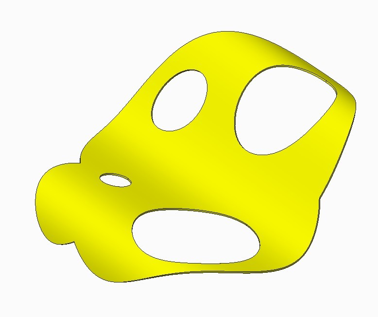

Actually the screenshot was of a simplified problem.
What I actually need, is to cut the holes in a double curved surface. I don't think that sheetmetal and spinal bend would help me here. Maybe? Otherwise it's a great way to do it.Thanks for the suggestions.
I manage to solve it by extruding the wrapped sketch that was projected back on a workplane... and because you can't wrap a sketch onto a double curved surface I had to create a single curved "dummy" surface that immitated the double curved surface as close as possible.
The result:
It's still just a test and not the final part.
Thank you very much for your help. You just helped me gain some new CAD skills

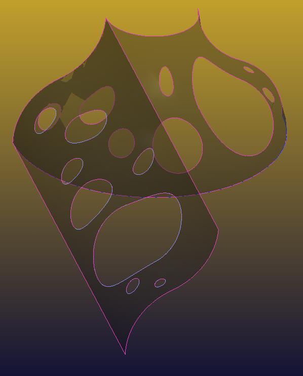

Just for fun, I wrapped a series of circles onto a "developable" surface thas has curvature normal to the exis of the final part. So, the circumference of the circles is correct (unlike projected). then I did a spinal bend on it to get the compound curvature (like a revolved surface). As you can see, now the holes are distorted near the top (smaller end) where the spinal bend actually shrunk the material. I wrote a relation to force the developed length to be equal to the big end. I could easily have donw it the other way with the relations to make the holes near the top undistorted and have the material stretch (as would more normally be the case) to distort the bottom. But, this was quick and easy. Note: This is sort of cheating to create a Toroidial bend, with greater flexibility. I later thickened it and it worked at 1" thick no problem!
For you though, what I'd suggest is simply punching holes thru a surface, normal to a point on the surface corresponding to where the axis of the hole goes thru, then thickening the surface. This will give you distortion of the walls of the holes, based on the thickness. This will most likely give you geometry most closely matched to a real world production process.

: 3dprint is going to be used as the manufacturing process in the real world. With the rather complex geometri (a lot of details will be added to the surface) that I need to be as precise as possible, and the fact that I only need one single piece, I think 3dprint is going to be the most suitable manufactoring proces.
I need to wrap it as much as possible, because I don't want the pattern to be stretched. The pattern is probably going to be more complex and not just simple circles. It was just for testing.
Unfortunatly I don't think I can use the spinal bend method as I need the double curved surface to be quite precise. I think it's easier to get an excact shape with a boundary blend tool compared to a spinal bend.

April 12, 2013
Well, it looks like you got it then. The pic looks good.
