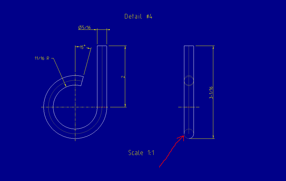

Does anyone know why I am getting the bottom part of the round on my side view to have a hidden line?

on my PC I can't reproduce the problem.
Add the following option at the end of config.pro file to turn off OPENGL graphics, restart ProE/Creo and check your drawing.
graphics win32_gdi
If the problem disappears then it is related to graphics drivers. Standard solution = update of graphic drivers.
What ProE/Creo version do you use ?

I will give that a try after lunch. We are using Creo Parametric 2.0 here.
