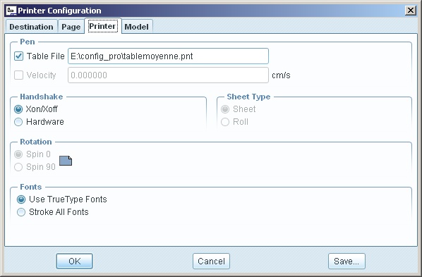

you have to change your pen table file (*.pnt) in order to set the thickness of printed lines.
You can search for "pen table file" in the help center.
If you use a pdf printer (like pdf creator or cutepdf writer ), this file have to be choosed in the printer configuration.
If you export your drawing as PDF file, you have to set "Use pentable" in the PDF export settings and you have to have a file called table.pnt in your working directory (unless you are using the config.pro option pen_table_file).
