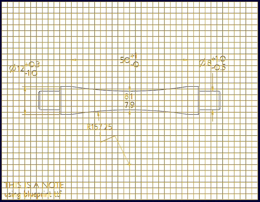

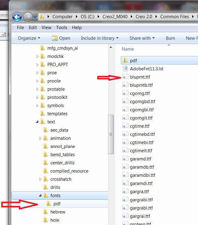

    I did a little investigation on this today.
    I stumbled across a PDF folder under the TTF folder. This got me thinking. The PDF folder is full of odd files none of which are purely TTF files. These must be conversion compensation files of sorts.
    My 1st test was to use one of the default fonts... bluprnt.ttf (nice architectural font!). What Jakub said about thickness not affecting TTF is true. In the case of this font, the aspect ration too is unaffected. Height is affected (obviously). However, when you use symbols (diameter symbol below) the system reverts back to the default symbol library library and thickness config setting does affect these.
    I plotted the drawing using the "USE TTF" option (no stroke) to PDF (save-as>export) and brought the BMP image back into the drawing as an overlay (underlay). The two compared very nicely!
    So what I am thinking is happening with the non-default TTF is that there is not a 1 for 1 conversion in that odd PDF folder. Also notice that odd file in the top of the font folder "AdobeFnt11.3.lst". Are only the default fonts compatible? I don't know yet, but this is a step in the right direction.
    In the case of bluprnt.ttf at least, it seems a WYSIWYG conversion.
