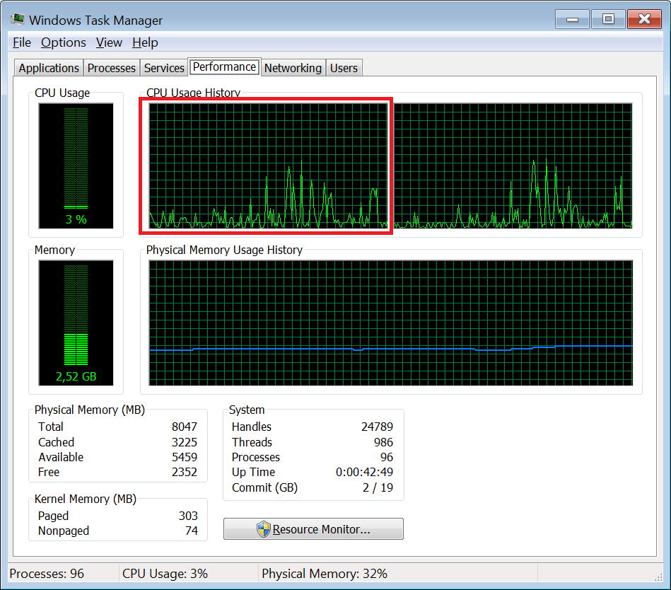

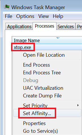

Launch Task Manager, select xtop.exe process, press right mouse button and click Set Affinity... command.
Uncheck all processor cores, but one.
In Task Manager, watch graph of selected core. If it is running on the top of the area, then you know that mostly single-threaded Creo gets all processor power - this means that processor is bottleneck for current operation.

You have to set affinity for xtop.exe process every time you launch Creo. When the setting is finished, operating system stops switching xtop.exe execution between processor cores. This means that xtop.exe is executing on single core and you can see if this core is 100% busy (i.e. fully loaded).
Creo is mostly single-threaded, this means its xtop.exe process is not able to use all processor cores simultaneously.
