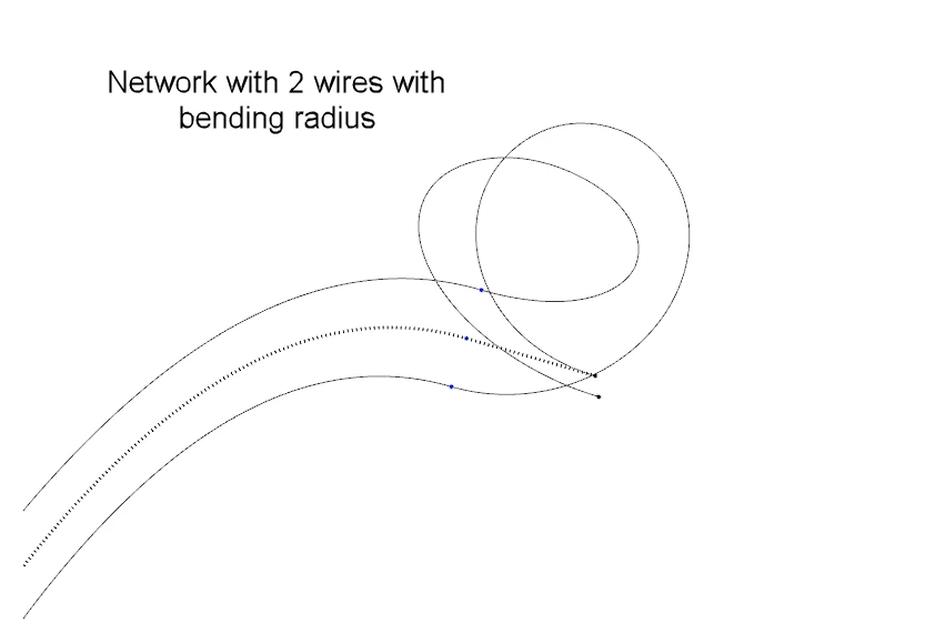

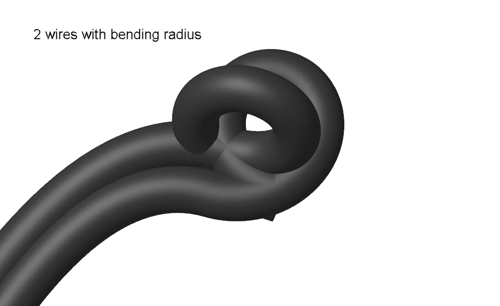

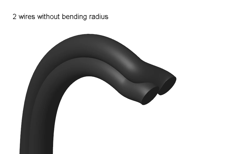

Hello everyone,
I hope I'm right here. With CREO-Cabling I have my problems. I want to route 2 wires. Via the spools, I have defined a bending radius that causes problems with the following topic. At the end of a network, the wires are always twisted so that the wires make a loop because of the bending radius. See pictures.
Twisting over the angle does not solve the problem either. How do you manage to run both cables straight and parallel to the end of the network?
Thank you
Marcel

I would not terminate the network to the connector coordinate. Usually I terminate the network to an offset distance x from the connector wire termination point. I my wires loop (as yours) then I move the last network point outward (away from the connector coordinate) until the wires don't loop any more.
As shown  on  link http://support.ptc.com/help/creo/creo_pma/usascii/index.html#page/electrical_design%2Fcable%2Fexercise_assigning_location_priority-for_network_locations.html%23 all the networks end at some distance from connector. If you use sheathed cable the cable sheath also ends at the last network point...
Br,
Lars
