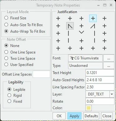

Is the "Multi-line Text" tool in Creo Schematics very tedious to use, or is it just my experience?
I am trying to place a multi-line note, in the Multi-line Text user interface the note looks as I want it to appear on the field of the drawing. However, when I place the note, it adds spaces between lines. I've tried changing the settings in the Temporary Note Properties GUI, but even those settings are hard to understand what they do. Help please

Hi Asa,
Yes it is tedious to use. A few things to note, you said line spacing is not what you want. Change the Line Spacing factor from 2.5  to 1 or similar value and hit apply after you make that change. Also might want to set the Layout model to Fixed size. Auto wrap does what it states.
