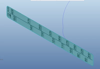

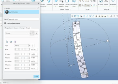

Hello everyone, Iโ€™m using Creo 8.0.9 and I need to create a sticker adapted to the surface, but for that Iโ€™m using a decal.
When the sticker is flat, applying the decal is easy, but when itโ€™s curved, it becomes very difficult.
Is there a better method?
Or is there any parameter in the planar mode that can be set to automatically adapt to all surfaces?

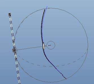

the surface its a extrude on a spinal bend
