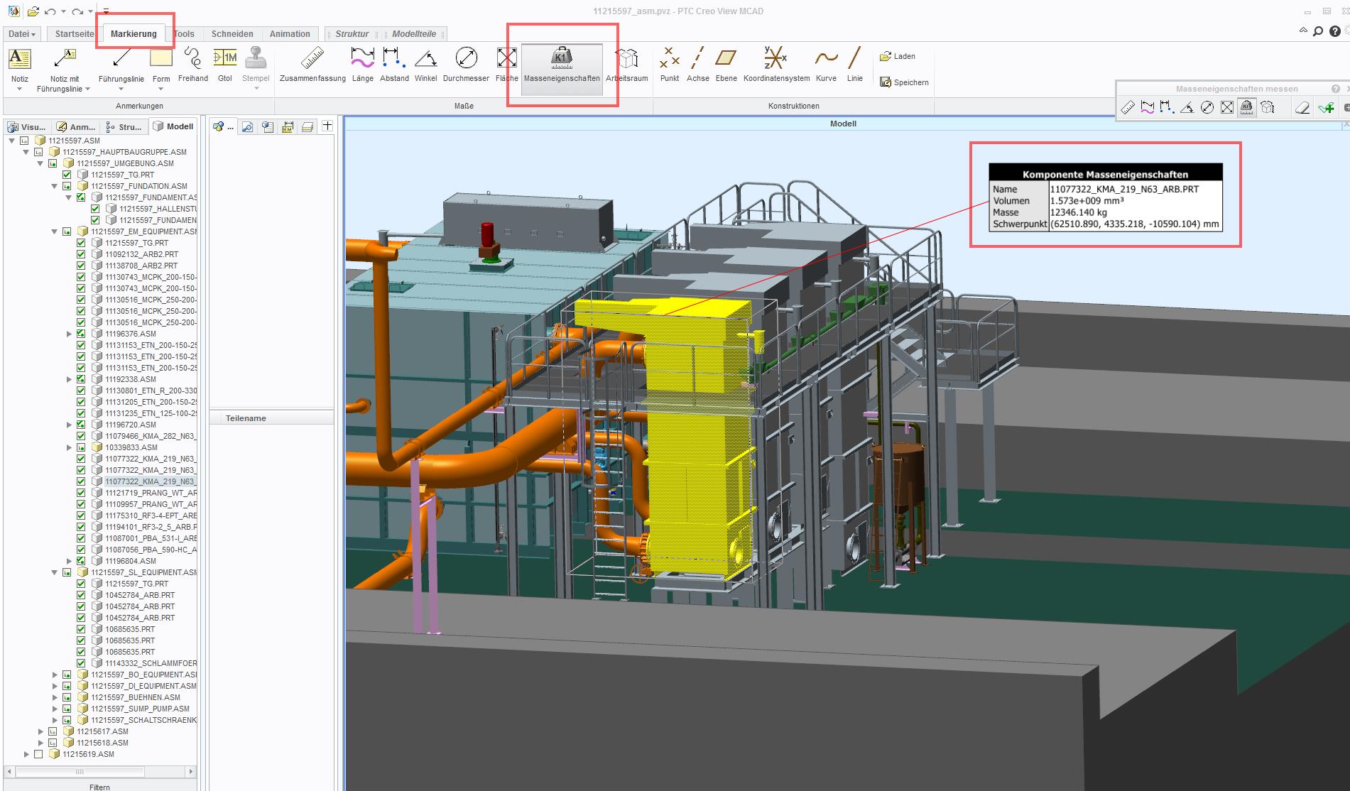

Hello Tommaso,
i'm using CV3.0 M031.
There is a volume function in the Markup Folder.
What's your Version ?
Ralf

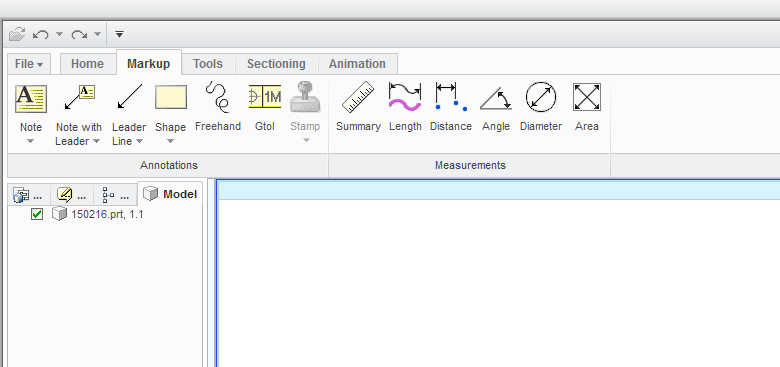

tleati12-AmethystAuthor
May 4, 2015
Hallo Ralf,
thanks for your reply. I have this version:
PTC Creo View Lite 10.2.20.23 M020
and as you can see in the screenshot below there is no Volume function:
bye

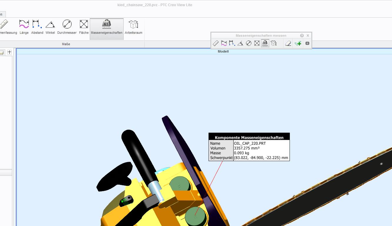

May 5, 2015
Lite is not the Problem. see my Screen.
check the Version. may this function is new in cv3.0
May 7, 2015
PTC support replied me with this case support "solution" that essentially says there is no way of measuring volume in Creo 3.0 Lite
https://support.ptc.com/appserver/cs/view/case_solution.jsp?n=CS159222&lang=en
and that if I want I can request this functionality with the "PRODUCT IDEAS"...this is madness
It's really incredible such a miss by PTC, really unconceivable...
so this software is practically useless to us for certain part such as foundry pieces, for which we need constant mass evaluations for cost extimations...non CAD-authors cannot have such numbers and I would therefore need to open Parametric- > find them automatically downloaded in Windchill workspace -> have to delete them from it
---> with the consewuent loss of time
at this point I will request a downgrade to 2.0 hoping it will work...
May 8, 2015
Hi Tomaso,
The document that tech support refers to is from April 2014 and isn't updated according to the latest release. In Creo View 3.0 M031 they have introduced both Mass Properties and Envelope. They are both part of the new measurement tool, also in Creo View Lite.
May 8, 2015
