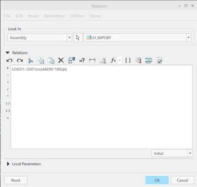

First create the parameter to hold the load value. (Tools Parameters - + )
Create User ParameterCreate User Parameter
Then show the angle dimension before entering Tools - relations so you can pick the dimension.
Then Tools-relations.  the angle dimension I have is d4696 but yours will be a different ID.  My example uses a cosine function.  Replace that with the function you need.
Define relation for load varianceDefine relation for load variance
Regenerate the model
Verify Parameter is now driven by a relation and locked.  Tools - parameters
Verify parameter is driven by relationVerify parameter is driven by relation

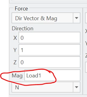

Now use the parameter by just entering its name in the load magnitude box.
Assign the Load with the parameter.Assign the Load with the parameter.
The design study would then as it varies the angle dimension, automatically update the load magnitude due to the relation and the parameter connection.

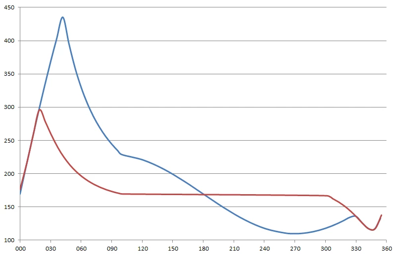

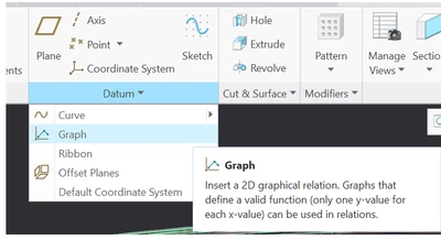

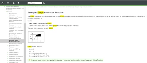

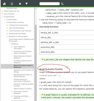

Thank you.  I think that's a good start.  But what if my function is more complicated than sin/cos?  Can I input a table?  This is my input torque curve, for example.
