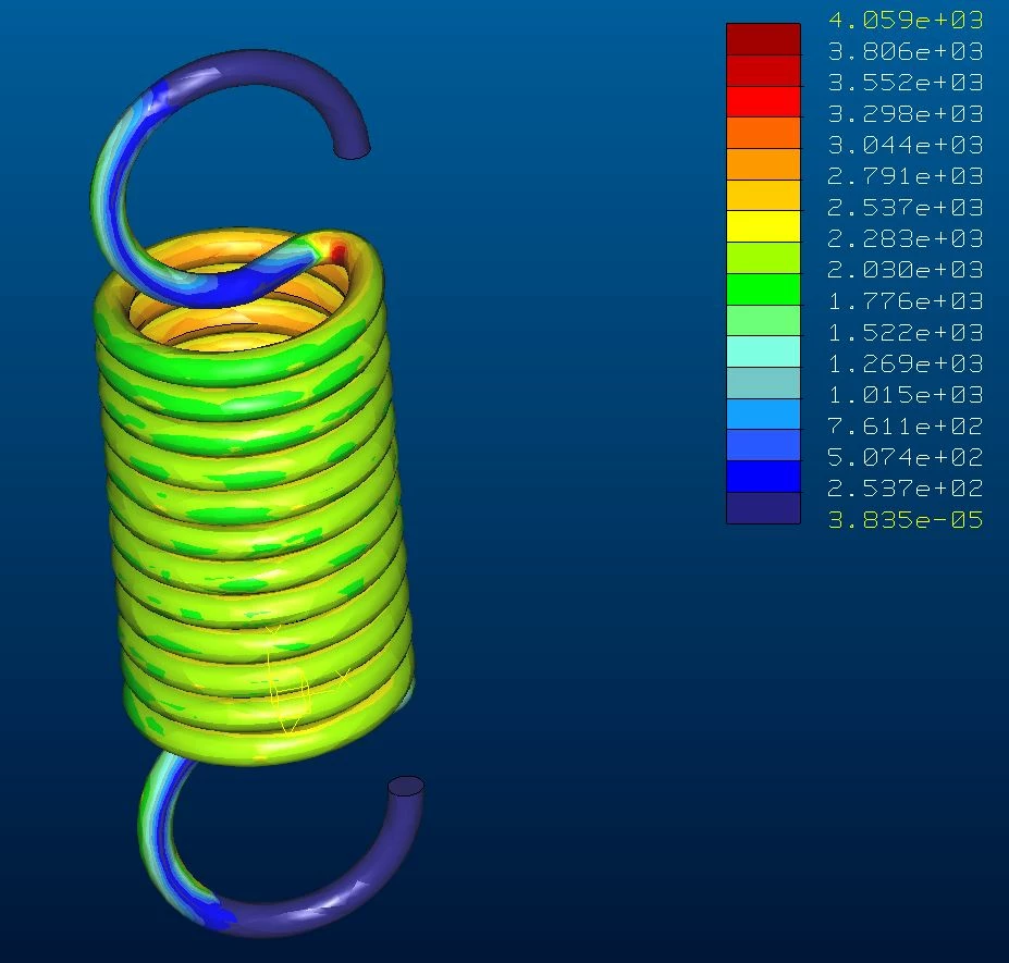

Hi all,
I've designed a spring and I want to see if the value of tensions are, more or less, the same I've calculated with the formulas.
The matetial is "springflex" with
E=206000 MPa
G=81500 MPa
Su=2270 MPa
d=0.9mm
In my calculation, the spring is verified.
Anyway, the results that Mechanica gives me (I've used WF5 for the FEM simulation) provides tensions much much high...
I've done two tipe of analysis:
1) I've imposed the displacement (35 mm)
2) I've imposed the force (25 N)
but, for me, the results are incorrect but I don't know why.
I've tryed "linear" and "non-linear" analisys for with large deformations.
Greetings

On your results comparison one can clearly see that the maximum shear stress is between 460 and 690MPa when the VM stress is comprised between 800 and 1200MPa. That's why, regarding the shear stress you were expecting, I was proposing you to look at the shear stress.

I have found a stiffness of 2N/mm with the force imposed analysis (displacement of 5,94mm for a load of 11,77N), it doesn't seem wrong...
Note that in your analysis the load isn't 25N, it's 11,77N.
gfraulini17-PeridotAuthor
December 3, 2013
You're right.
I should have put 25.938 N as force.
But, anyway, what can you tell me about the tension over the wire?
I attach results of Von Mises Stress in MPa.
December 3, 2013
At first sight, it looks OK.
Why did you think it was incorrect ?
