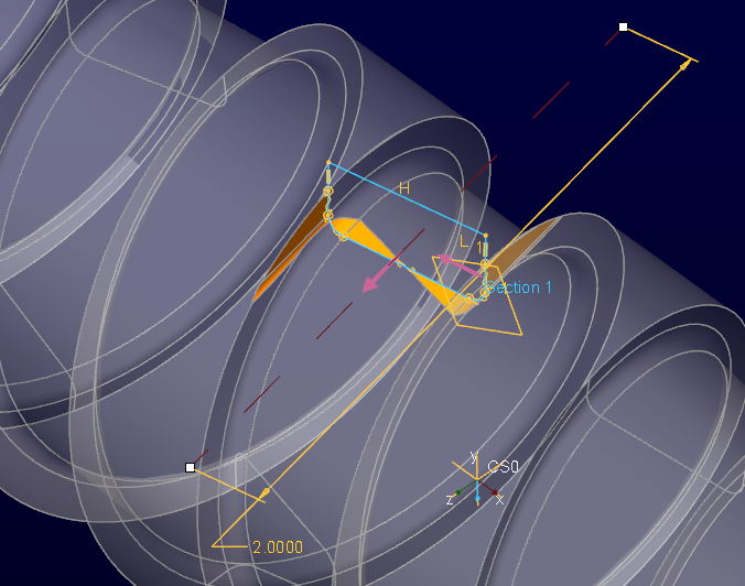

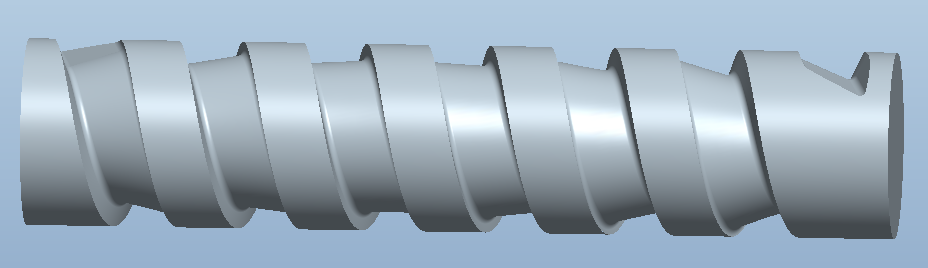

Timing Screw
Dear
I see one function to design Timing Screw is good
https://www.youtube.com/watch?v=gdRKmJHwPvI
How in Creo have this function:
The fuction is not sweep or Var section sweep
This function is: Sweep with variable pitch cut from one extrude body (In creo just sweep from section, this is sweep cut from body)
Please help & discuss how to do in Creo
Thanks & Regards
25 replies
January 22, 2014
You should be able to create a graph to change the angle (rotate) the section as it moves down the trajectory.
January 22, 2014
Here's a quick example of what I mean.
January 22, 2014
If is follows a constant angle change of the "tool" it could be a variable section sweep using trajpar along a spiral guide path (origin). The path would incorporate the pitch variation, if needed, by wrapping a sketch onto the cylinder.
