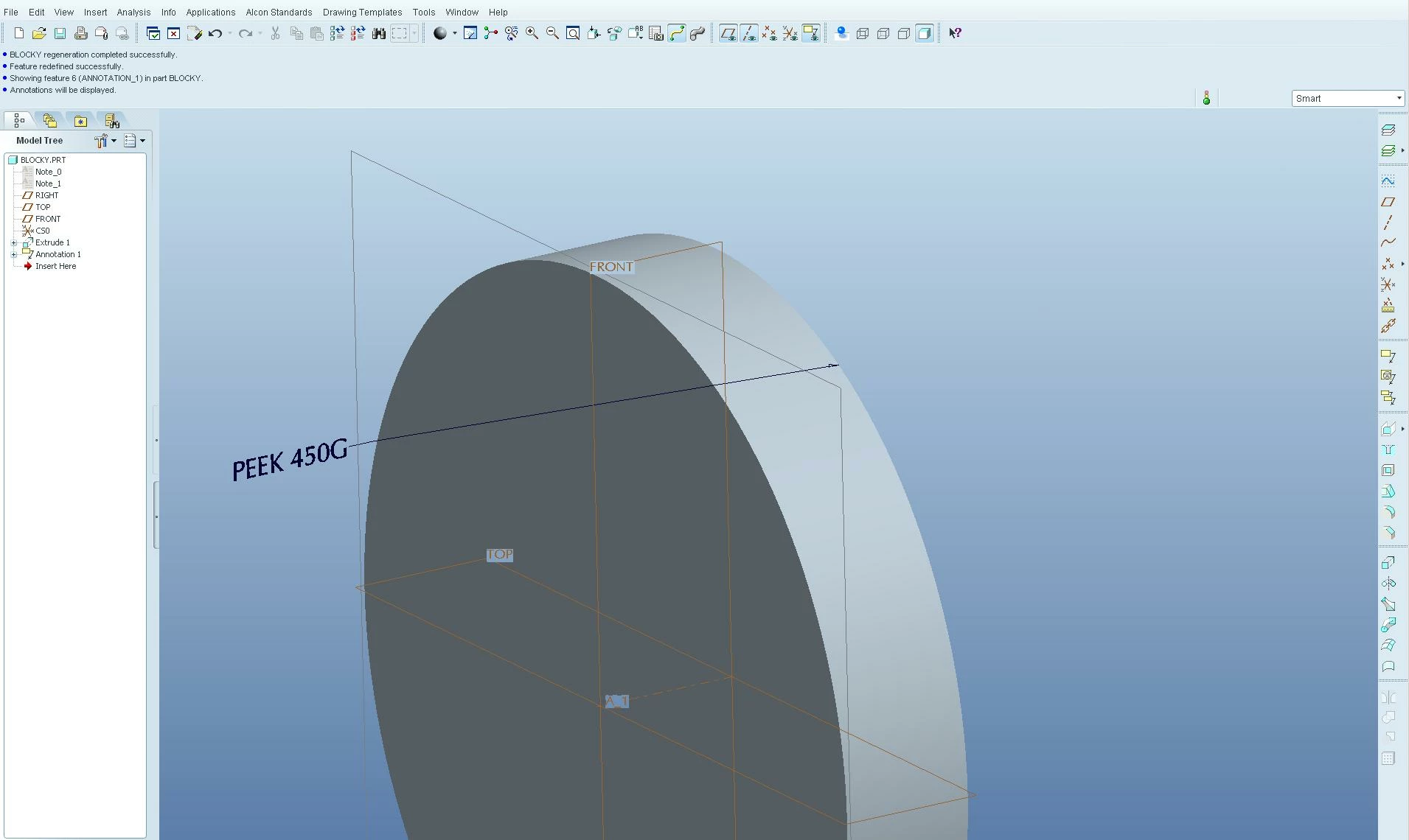

I just add an Annotation feature with &materialand I can display the note or not as I wish.
Fast, fast....
Dean

Have to agree that there is a lot of room for improvement in the material files in Pro/E / Creo. We use them to carry parameters, hatch pattern, material characteristicsand forMechanica studies etc..As others have said though,I wish it would lock out the ability to change the density when a material file is assigned (or mess with the settings in the assigned material file). Even if it was a config.pro yes/no sort of thing that could be put in a config.sup. Other thing that has bugged me is the fact that while a x-section willuse the hatch pattern associated with the assigned material file (nice), ifa different material is later assigned and has a different hatch pattern, the section doesn't actually update, it keeps using the original material's hatch pattern.I like the idea mentioned here of using a annotation feature to communicate the assigned material file. One thing I've done that has helped our users is create a custom BOM report form - when the users run a BOM report in Pro/E it includes columns for the name of the assigned material file, density and mass of the part. Makes for a quick check of what may be incorrectly set when a mass properties report doesn't seem right.
