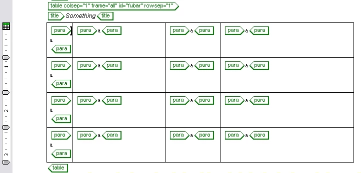

    I wouldn't really have a problem with the change to picas if the Arbortext S1000D Publisher (at my current version) output the variable column widths in picas. This it doesn't seem to do with the content I have. I'm not sure why that is.
    I have a bunch of tables that came out of various MS Word documents via MS Excel, and I've been doing some tinkering as well with Arbortext Import to bring in those tables without using Excel as the go between.
    The Arbortext Import tool gave very clean xml overall but was considerably more effort to get a similar result. In any event, the result is exactly the same no matter where the table came from, the column widths are modified to picas by the CSDB Save and the PDF column output is divided evenly within 38 picas in the output by the publisher.
    I think what I'm going to do today is construct some tables directly in the editor and see what happens to those variable columns.

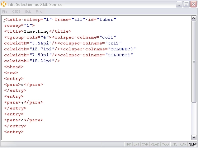

    I constructed some very simple tables this morning and here are some
    screenshots which show the problem I'm having. So the issue has nothing
    at all to do with any tables imported from other sources.
    Greg

    Thanks for the idea, I just gave it a try, the CSDB Save function returns the values to "pi". I sense a theme... 😉 Basically whatever I enter for a measurement be it mm or in. gets converted to picas.
