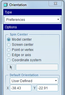

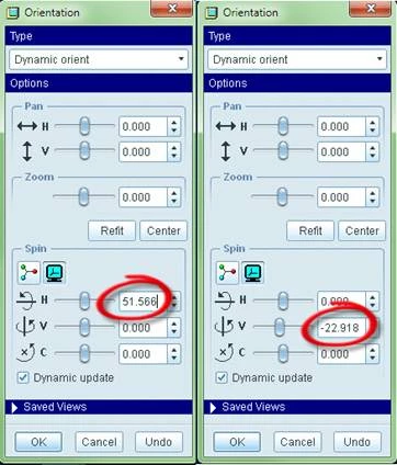

    Those numbers don't seem to agree with the out-of-the-box "Trimetric" view. Looking at the front view I need to tip the model forward (horizontal axis) 51.57 degrees and then rotate left (vertical axis) 22.91 degrees to match the existing trimetric view.
    I use derivatives of these values for the user defined default orientation to get "Z" pointing up (world CS) instead of at the screen from a front view. (-38.43 = 51.57 - 90)
    [cid:image001.png@01CF23DE.509E7EB0] [cid:image005.jpg@01CF23DF.663FCC50]
    I hate the way this comes setup out of the box. In my mind the Z axis should be coming out of the top plane, not the front plane.
    [cid:image004.png@01CF23DF.66362F60]

    The exact numbers are in radians.
    From a front view rotate about the horizontal .9 radians (51.5662...deg) and then rotate about the vertical -.4 radians (-22.9183...deg).
