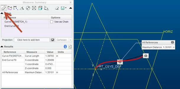

In Creo2 I am trying to measuredistance from one vertex to another vertex of asame planar spline.In other words, the two ends of a squiggly curve.
The message I get back is "This measurement cannot be performed for the given set of references" Huh?
I can get a measurement from one end verex to the CSYS but not from end to end. My curve is located and dimensioned with Strong dims so it's located in space.

    In Creo 2.0, pick the Measure Summary option, select the curve, then using the Ctrl Key pick one end vertex. You will get the X, Y, znd Z coordinates of the vertex, the Curve Length, and the Maximum Distance all in once screen. 3 picks including the selection of the Summary icon
    If I were to pick the other vertex I still get the overall Curve Length and the Maximum Distance measurement but my X, Y, Z coordinates change to the other vertex location values

    The way I was pickingto measure the distancemade it require more clicks than is needed demonstrated by Mike's clarification. Operator error.It is really about the same number of clicks as Wildfire releases to measure things.

    The measure tool is actually one of the biggest improvements in Creo. Click measure (summary), click an item and Creo will tell you pretty much everything it knows about it. Hold control and pick another, and it'll tell you all it knows about both together. If one is a line, planar surface or cylinder you can choose if to use it as an line, plane or center. A lot of info in a few clicks.
    Back in WF3 when PTC made a mess of the measure tool, a lot of us told PTC to look at SW's measure tool. They did, and delivered a tool that's far superior. In SW I now wish it had the Creo capabilities.
    This is the first odd scenario I've found with it, and if you use Mike's method (or the method I posted earlier) it's not bad at all. What I'm saying is don't be afraid of Creo based on what you read here, it's overall an improvement over WF5 and earlier.
