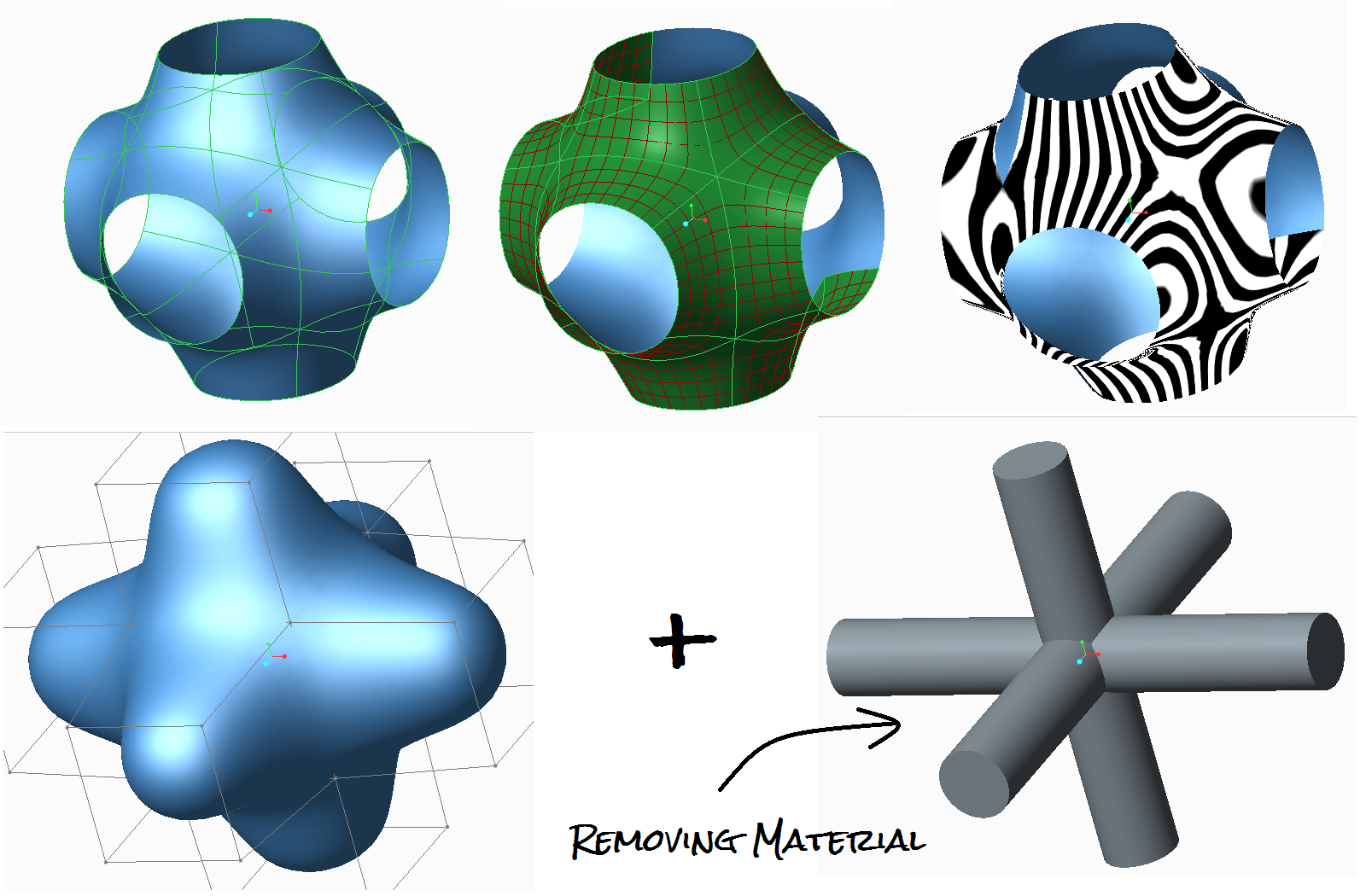

Does anybody know how to create this model ?
I want to create the attached model. Pls help !!
    28 replies
    Mar 31, 2016 12:04 PM UTC
    My quick stab at it.
    I used extrusions, rounds, then shelled.
    I'm sure there are many other ways to tackle this, here is one.
    Ron

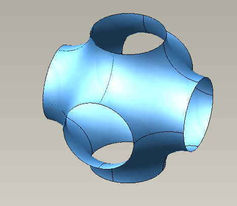

    Mar 31, 2016 12:27 PM UTC
    I used curves and the style feature to create a surface model.

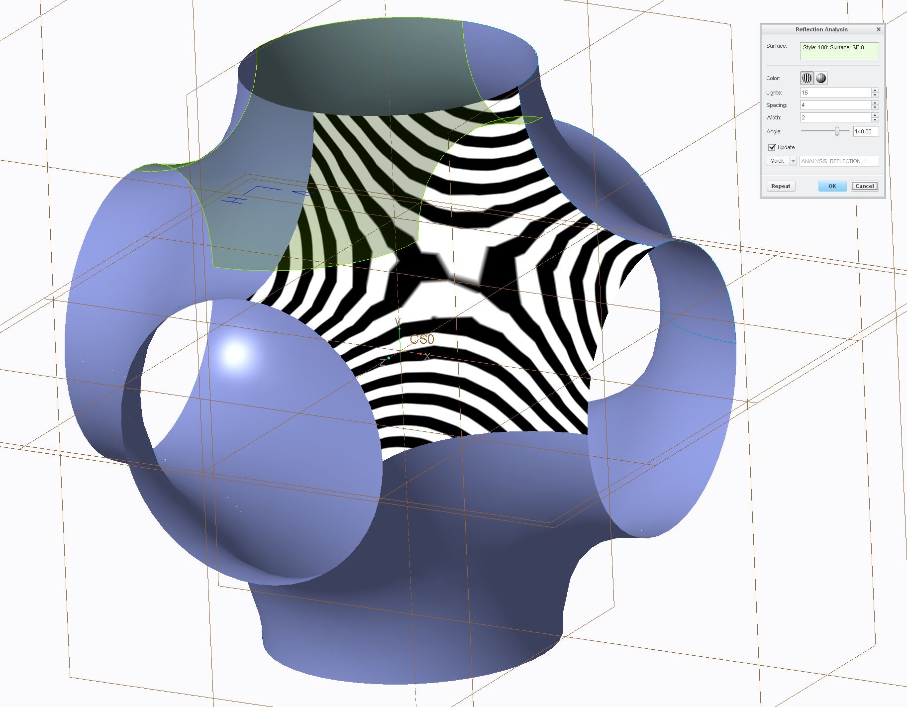

    Mar 31, 2016 2:05 PM UTC
    I would say yours is the best so far -assuming that the requirement was for circular apertures.....the middle of the surfaces are not that great though when you analise with reflections, but probably good enough for the part Mani needs. I think that is just what happens with N sided surfaces in Style / ISDXsurface_relections.JPG
    StephenW
    Mar 31, 2016 2:13 PM UTC
    I was surprised how good it came out on the first try.

    Mar 31, 2016 4:19 PM UTC
    I used the N-Sided patch tool which worked quite well, actually.  I was surprised, I've not had a lt of luck with it.
    I assumed that the part was symmetric but that the outlets weren't all the same diameter nor the same offset.  Outlets on each axis can be changed independently and the offsets can as well.  Part is pretty flexible, but the shape gets a little odd at extremes.
    Creo 3 part attached.

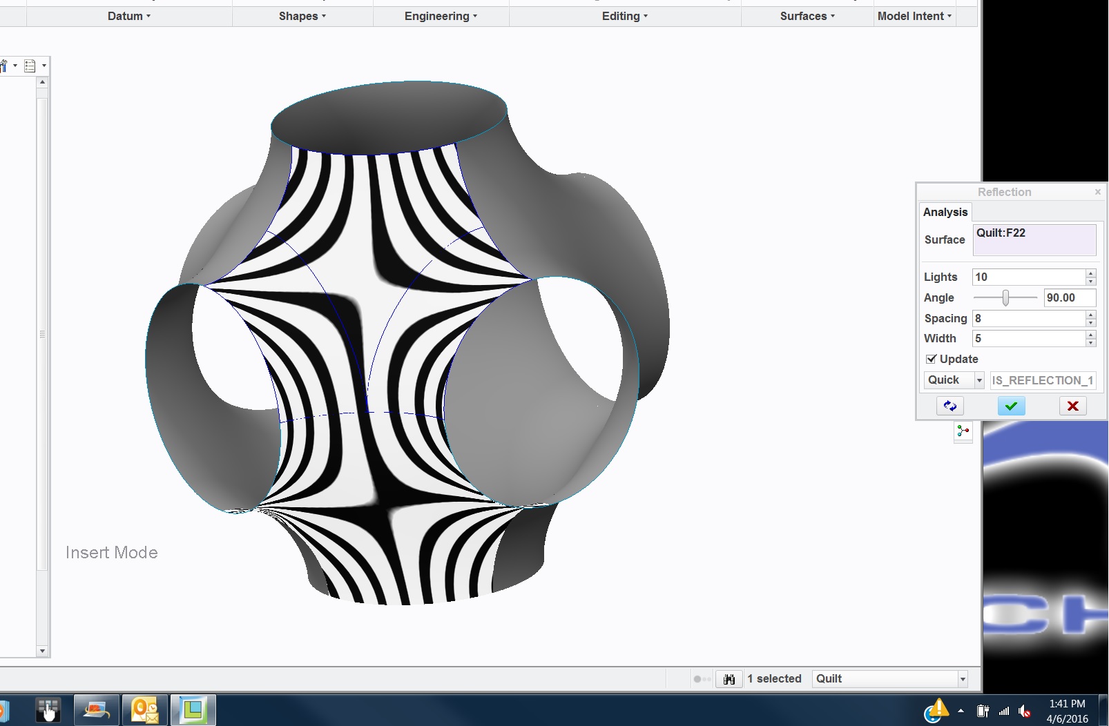

    Apr 4, 2016 4:04 PM UTC
    I started down this path too, but I couldn't get Creo to make all the individual boundary blends and make them tangent.  Were you able to do so?
    Apr 4, 2016 4:38 PM UTC
    Doug; under the tabs in the dialog, there is a place you can set the state of the edges.  You get free, normal, tangent and curvature.
    You can also click on the white bubble with the black dots in the graphics window.  In the dialog, you can set of change the feature you want Normal, tangency, or curvature from.
    And you can also assign you own connecting points.  Boundary blend is simply full of little Easter eggs.
    Apr 4, 2016 5:13 PM UTC
    I'm familiar with the controls, what I meant was that when I set them to be either tangent to the adjacent surface or normal to the plane the curve was sketched on, Creo refused to build them  Some of them refused to build at all because it said the corners were not joined, even though the curves were defined as aligned to one another.  Thinking about it again, I believe I was using normal to the sketch plane and that wasn't necessarily true, since I wasn't building a fully symmetric part.
    Unfortunately, I didn't save that version with the additional curves.  Maybe I'll go back to the one I built with the N-sided patch and try again if I have time.

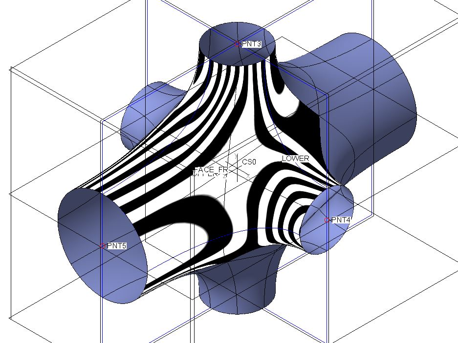

    Apr 6, 2016 5:44 PM UTC
    Style feature works as well.
    Three sketches, one style feature then mirrors.
    Apr 7, 2016 1:22 AM UTC
    @ Steve
    Now that I've played with this method, how did you determine the diagonal section parameters.
    That 3 way union radial distance isn't defined unless you start with a sphere.
    Apr 7, 2016 12:41 PM UTC
    I'm not sure how Steven did it, but you can find my model with all the curves a couple of posts above:
    Re: Does anybody know how to create this model ?
    Apr 7, 2016 5:02 PM UTC
    The N-Sided surface is very nice when defining the periphery as one surface.
    That section through the diagonal can be defined in many different ways but in general, it becomes a very critical junction - IF - you're going to try to define it.
    I am not sure if Steve did define this and if so, using what type of feature.
    Technically, I would try to specify the spherical radius for the 8 "points" of intersection.  However, it is very easy to define a really crummy surface regardless of tangency or continuity.
