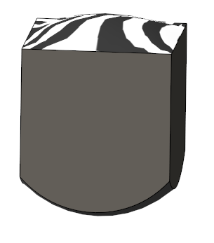

For a project I need to create a shape exactly like the picture I added. I've been trying to create it with solids or surfaces but I didn't succeed.
I've been searching in the PTC community and youtube but I didn't find the answer to my question, so now I'm trying this way. Can anyone help me to create this shape in Creo 2.0?
Thanks in advance,
Sander

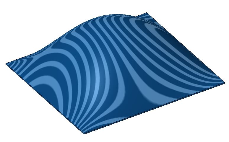

    You can do something close with a boundary blend.  The same of the base will affect the shape of the dome and it may not be as smooth as your image shows.
    See the attached Creo 2 model:

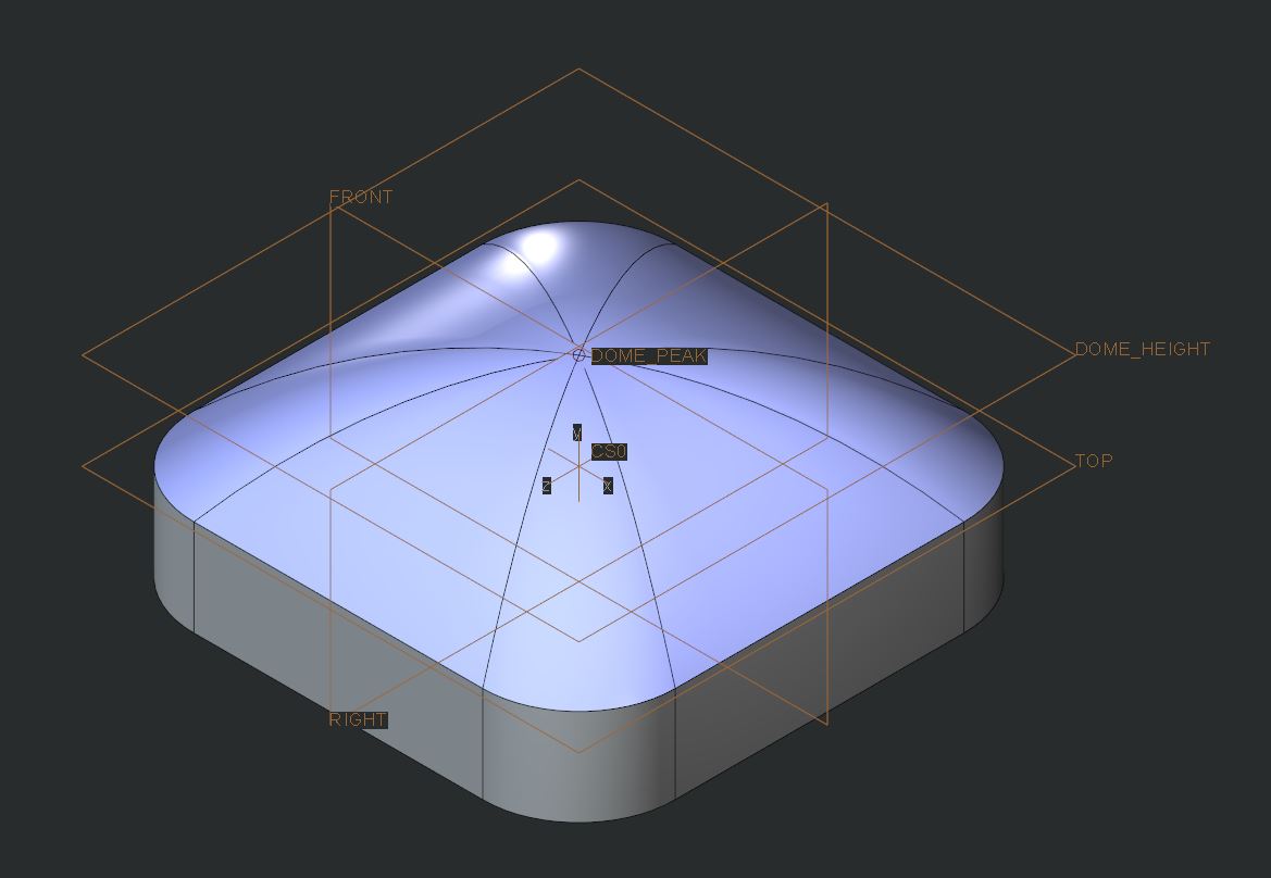

    November 7, 2016

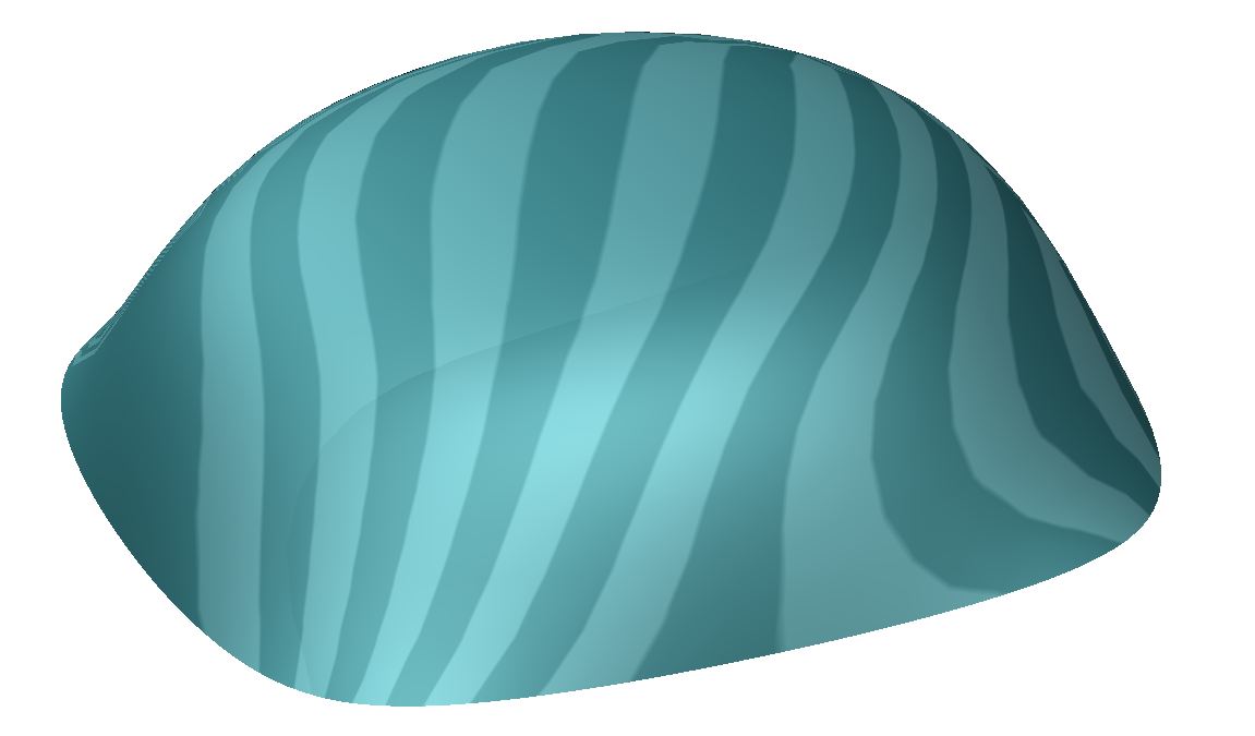

    Looks like the top of a sphere squared off and drafted with rounds.  My quick shot at a model is attached.

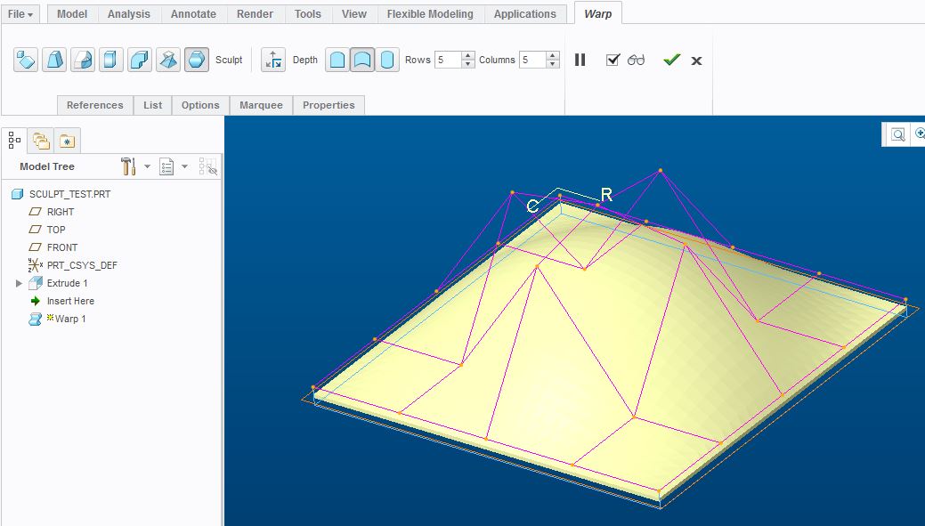

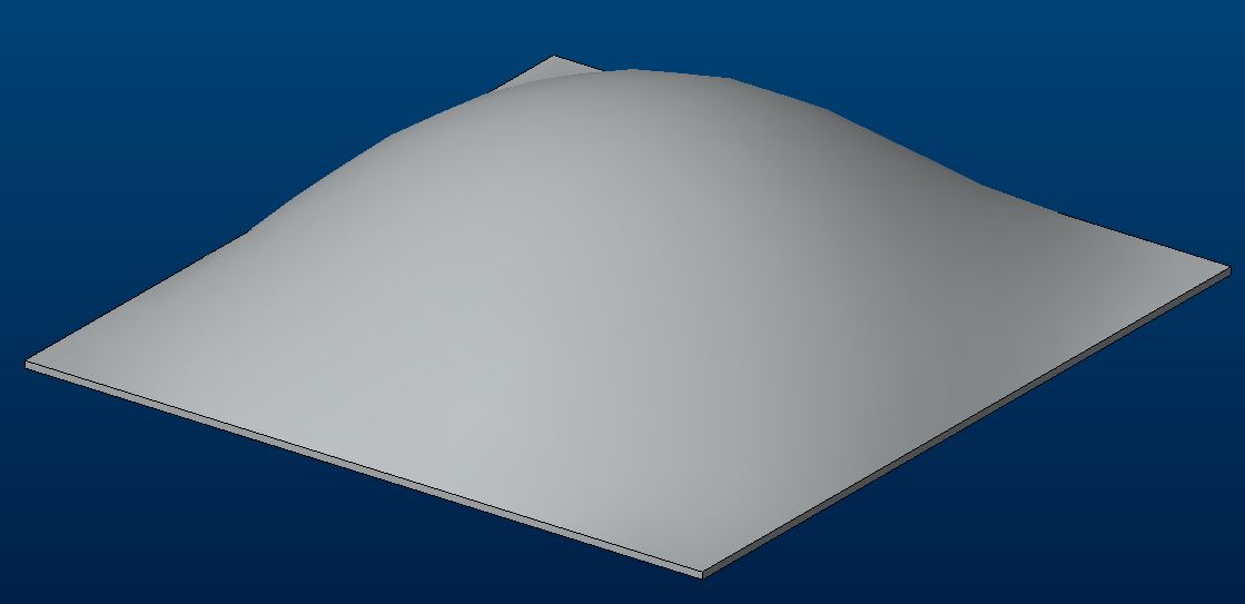

    The part seems to be vacuum formed and I think the square frame is not with rounded corners.
    My selection would be a warp feature with sculpt tool applied to a straight plate:
    The result will be something like this:
    Not very accurate but perhaps you get the idea.
    EDIT: Creo 2 example file attached
    BHOoi

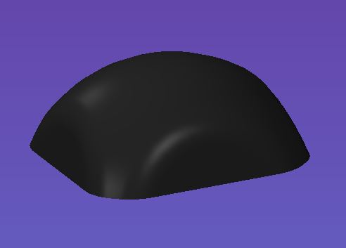

    I blew some more air to my model by dragging the sculpt control points up and it looks like this.

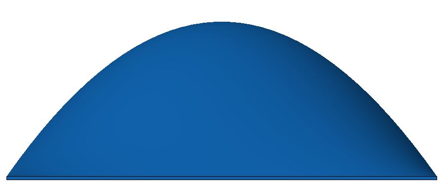

    Side view:
    Reflection analysis:

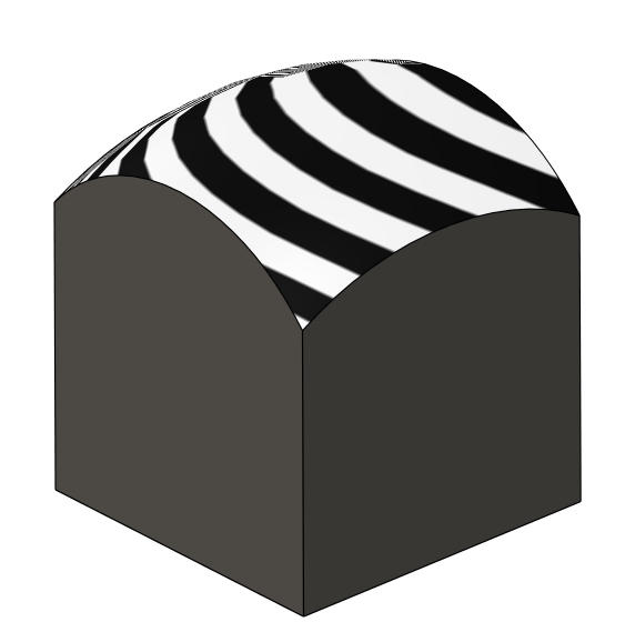

    Does anyone remember the old Dome command. It was back on rev 17 - 19.
    The command is still available. Need to add the following line to the config.pro:
    allow_anatomic_features yes
    Then type Dome in command search box.
    There are two options: Radius Dome and Section Dome
    Section Dome:
    The radius dome doesn't look too well on reflection analysis:
    Creo 2 part attached.
