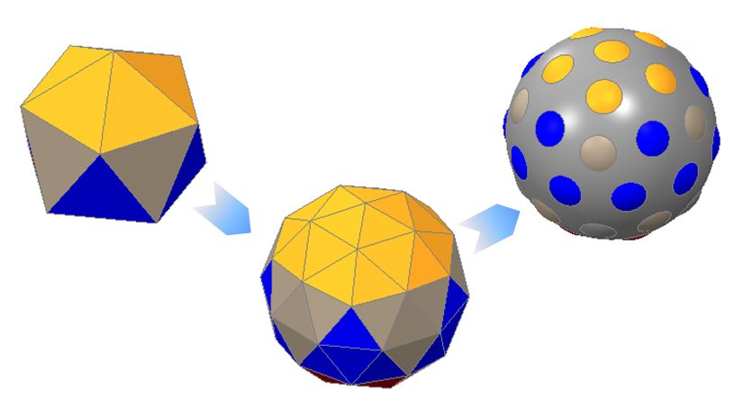

    Patriot_1776
    Oct 11, 2016 1:52 PM UTC
    Pshaw, that's easy.....I just put one point at the North pole, and one at the South pole (2 "points" total), exactly per your request, done!

    Patriot_1776
    Oct 13, 2016 1:11 PM UTC
    Actually, I never got to play around with making a golf ball, but, this is exactly what I was thinking I would try.  Since a sphere can be divided up into equal triangular facets, I figured an approach like this would work.  Nice find!

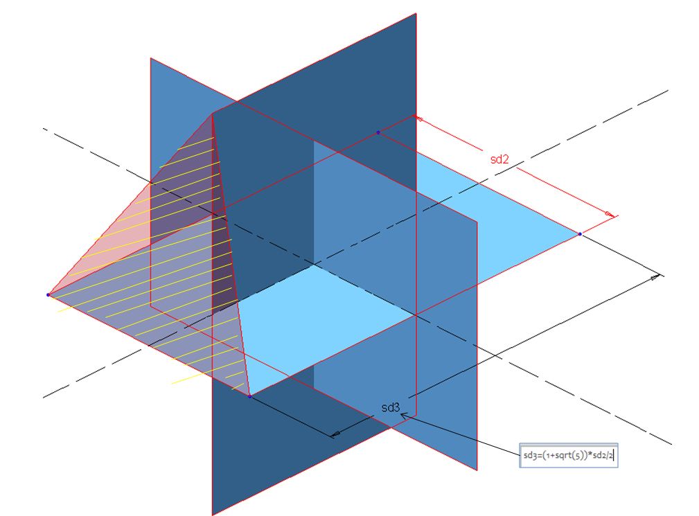

    This is how I construted the edges of the trinagle of regular icosahedron.

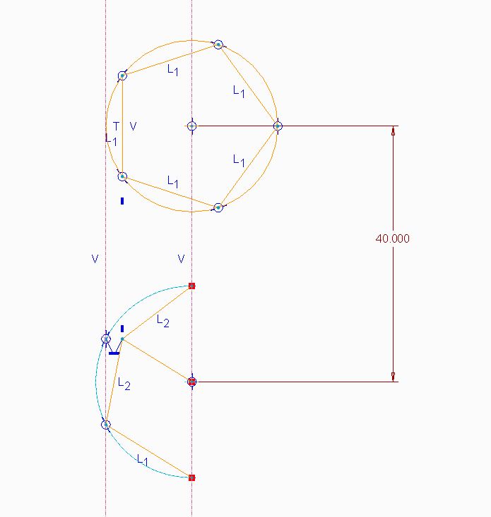

    Oct 14, 2016 2:55 AM UTC
    another approach:
    Oct 14, 2016 3:23 PM UTC
    Wiki has info that talks point distances relate to the radius of a sphere. The simplest approach for the icosahedron that I found is to create a sketch with the diameter desired, create a line that goes through the center with the ends on the circle, place points on each end of the line since the points will alternate from northern to southern hemisphere, write a relation for the angle of the line from the latitudinal plane of arctan(.5), pattern the sketch about the longitudinal axis with a spacing of 5 element within 360 degrees, and the final two points are at the north and south poles of the sphere.
