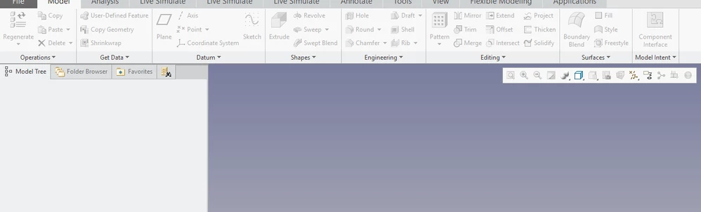

I created a part window using the code:
      Model tryModel = curSession.CreatePart ("Testing1");
      tryModel.Display ();
Here's what happened:

The condition is not met and a warning appears:
How to create a model in a tree?
