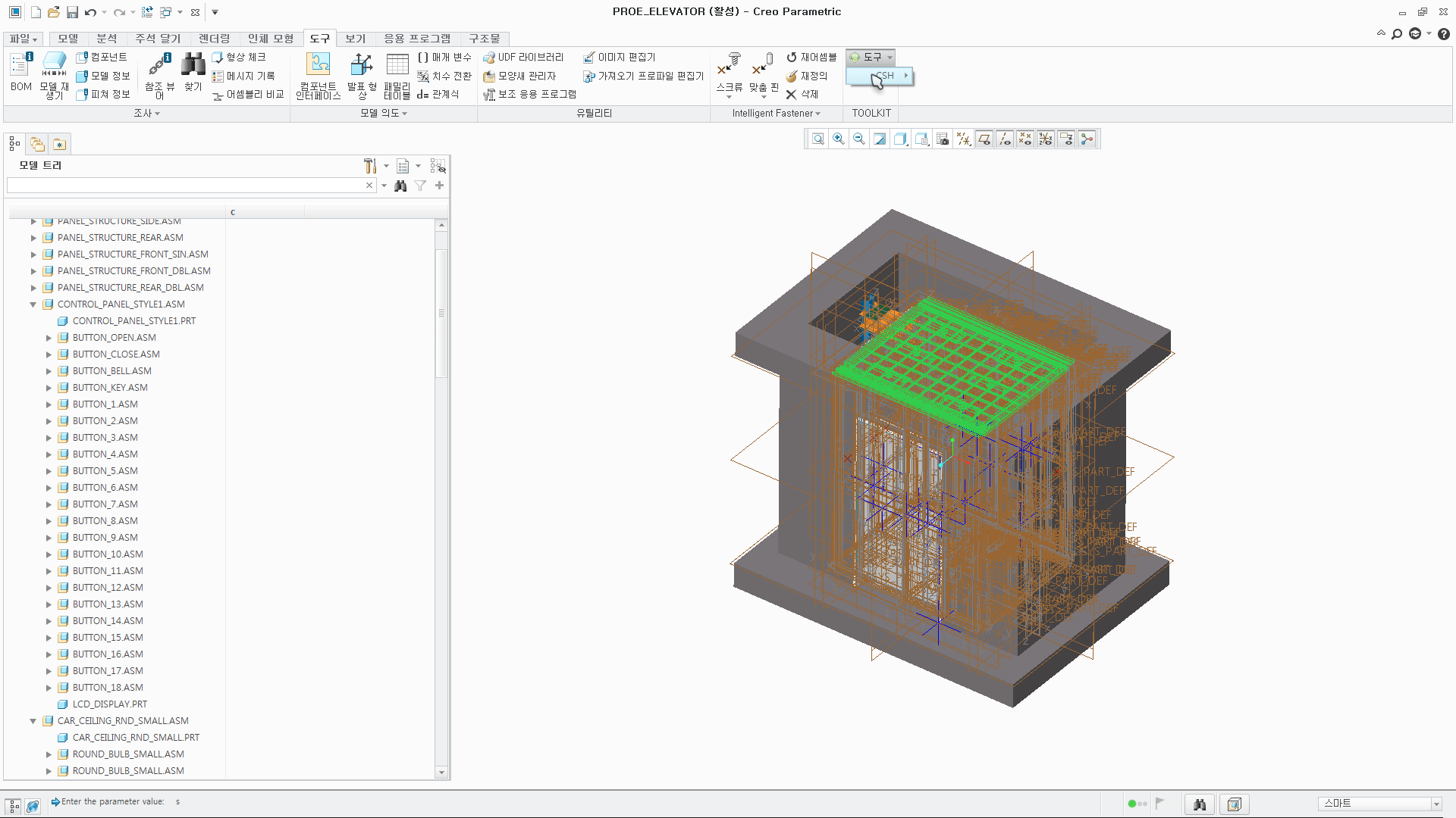

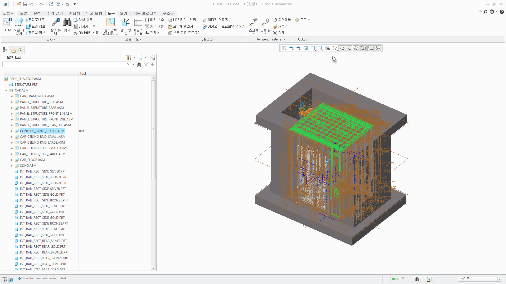

How to get all the child elements of a model
Attach the used model and code.
If the subelement of the model is an assembly, you want to recursively call the function to perform a specific task.
Levels 1 and 2 work safely.
At level 3 or higher, the function is infinite.
UgAsmCompVisit_c does not help me.
It is not appropriate for us to fetch information from the session model.(ProSessionMdlList)
Therefore, ProSelect attempts to visit the sub-elements of the selected model.
Help.. plz...

By declaring and comparing one more array, we avoided an infinite loop.
