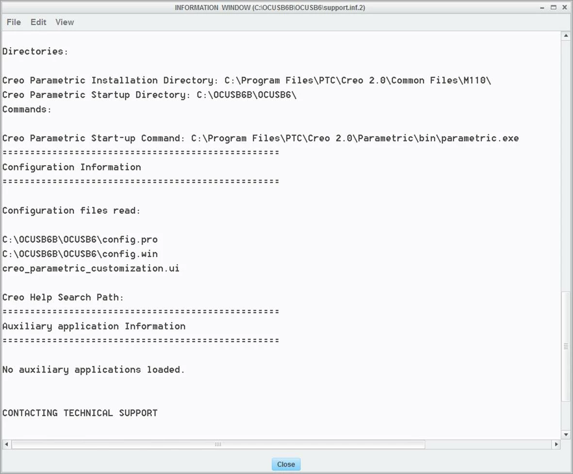

Hi all,
I see exactly the same results on my Dell T1700 with Creo Parametric 2.0.
M110 shows about 10 times slower PDF and DXF creation times compared to M100 (OCUS Benchmark v6 64bit - tests 36 and 37)
http://www.proesite.com/cgi-bin/ocusb6.cgi?v=All&srt=total&cmp=0&sub=1&srch=benchmark+t1700&sfrm=0&lid=20&64bit=1
(and I also see it on my Dell M6500 with the normal benchmark)
The problem goes away when using the config setting: windows_browser_type set to mozilla_based_browser.
The results for DXF and PDF creation are then back to normal (practically the same as M100).
This option was not included in the OCUS Benchmark config.pro. The default for this option is ie_in_process for M100 as well as M110.
You can include it in the config.pro manually, but I have also updated the benchmark config.pro (download version 6.0.1)
Note: I'm running Creo Parametric unlinked to Windchill ...
I have created a medium severity case on PTC.com (#12026663).
