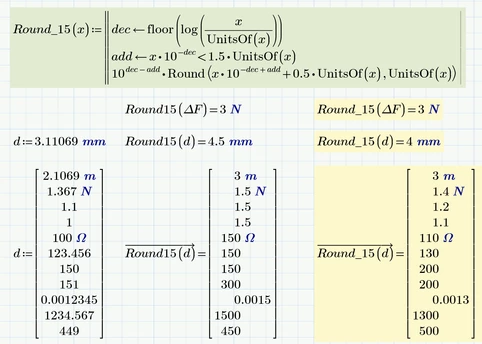

So here is a quick hack, a new function "Round_15" which seems to to what you are asking for.
I could not use "Ceil" (see "Round_15_(..) in the attached sheet) because this function would not round 1,0 up to 2. So I had to use the old method of adding 0.5 and using the normal "Round" function.
The function has no error checking, so don't feed it with arguments <=0 😉
i have the feeling that this function can be written much more compact and elegant, but...
Prime 6 sheet attached

Thanks for those but i didnt found answer to my task. I have to get mathcad round my error estimate with 15 digit rule.
Like if i have ΔF=2.1069 when its rounded its 3. 15 doesnt fit to 2, 15 fits in 21 then one number back and round upwards to 3
And if ΔF=1.4678 its 1.5.   15 doesnt fit to 1, doesnt fit to 14, fits in 146 one number back and round upwards to 1.5
I know how to do it on paper but how i can get mathcad to do it :DD
