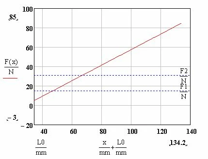

Hello everybody,
I have a very simple question: is it possible to add a point in a 2D plot as a single value representation, along with other function graphs? I mean, for example, I have a force diagram of a traction spring (a line) and I want to add a point of this diagram which will show the current parameters of the spring (force vs. dx). If I just add the current value of the force to the "y" axis of the diagram, I will get a horizontal line for that value... It has to be a simple way to represent just the point... but how?
Thanks in advance for your answers!
Conrad

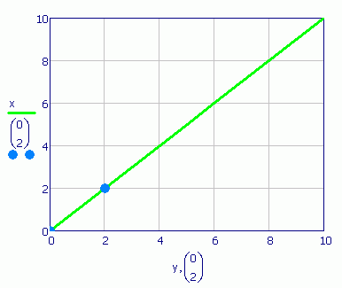

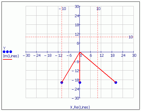

You can add markers on the x and y axis of graphs. you can also plot points. Have a look at the attached image.
Post a worksheet of the example.
Mike

I know I can use markers and that I can change the symbols for a graph, what I want is to have a graphical representation of a [a, f(a)] point, What I'm getting now is a diagram of f(a) over the whole x range (so a horizontal line, cause I have a single value for f(a)), meaning something like [x, f(a)]...
Basically, I want to get 2 single points instead of the 2 blue horizontal lines (please see attached picture).

Something like the attached?
Mike
